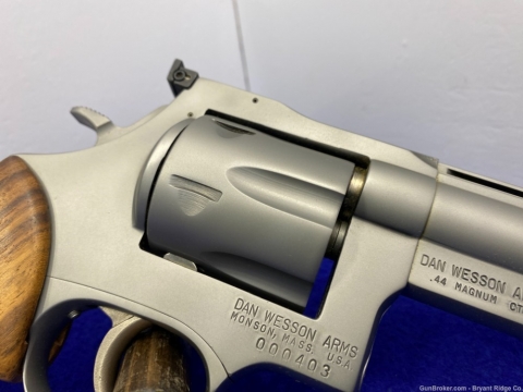

Doesn't look right to me.
https://www.gunbroker.com/Item/1043973365
Might be missing the "G" in the SER# that last two sold Dove Gray listings had: (000108 & G000403)
Not a DW-issue  case.
Only the 6" is original match to the gun.
The finish looks to be a coating.
Engravings are not crisp and refined.

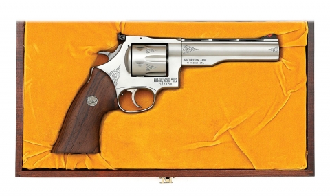

Here is an authentic one:
1of250.jpgImage Enlarger
A "G" in the serial number? Do you have a link showing the G000403 by chance? Just curious. While 000403 would fall in the 2nd run of Dove Gray (non-engraved) guns, I have never seen a letter as part of the S/N on one of these.

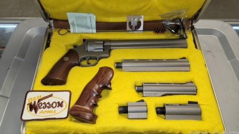

Anyway, regarding the one in question on GB...yes, it should have started life as an actual Dove Gray engraved (one of 250) Model 44. Yes, the 6" BA would have been original to that gun...BUT the rest is a mish-mash of assorted bits-n-pieces. Judging from the caliber roll marks, the 10" BA appears to be a later CZ style shroud, the 8" & 4" appear to be early CZ shrouds, and the 2" snubby has no roll mark at all. screwy Then the whole mess was refinished in the same (I have no idea the of type of material...maybe a gray truck bedliner?) finish, to make it look like this is supposed to pass as what, a Dove Gray Pistol Pac??screwyscrewy  At this point, I'm amazed they removed the grips & sights before they blasted the finish on. I love how he added "The revolver appears to be unfired other than maybe factory test firing"...I don't believe that for one second! Wait...actually, I do. Unfired after the poor thing was blasted with the mystery finish...probably because the action no longer works!
Oh, and not that it's a big deal, but the Pac case is an American Tourister briefcase, minus it's badge...I know, because those are my personal favorites to make my own Pac cases with. wink Only I prefer my handles hinged, unlike this one. And the "DW Model 744" sticker is wrong, that is not a stainless gun!
But my absolute favorite line in the description is..."original cleaning brush and unopened key to the suitcase". That "unopened key" is jammed between the halves of a paper coin folder flip card...anyone who collects coins will instantly see it. So I guess the "unopened" part is that the key didn't fall out of that flip card before the photo was taken.lol2

Charger Fan is absolutely right about every critique he made about the "Pack". I have 2 of the" lightly engraved" guns. The frame and the 6" are all that is original, albet given the same coating as the rest of the mishmash. Also, the second grip is a Hogue.
  And there is no 3" BA. 🙄. What I would like to know is does the seller have a clue?

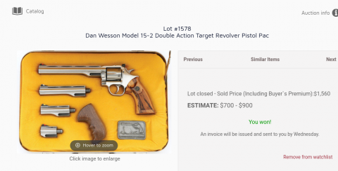

Yea i'm not looking for one. To me it's just a 44 mag not real special but if I did go after one it would be an engraved one. I was just wondering because Scout just got one in the original box for around $1600 That's the pic he posted. That was the first only the second one I saw in the original wood case engraved so yea I guess they are rare with the number that's available.  I was bidding on it too but he wanted it so I bowed out. I was happy I got the original nickel model 15 for under $800 with the extra barrel but I still have not picked it up so was waiting until I saw it in person. I picked up a 715 pistol pac in the same action for $1300 I could not believe nobody bid on it. Of course I had to pay the stupid shipping and the 15% fee so it was just over $1600 still a good deal. I'm tapped out after buying Dan Fan's 7445 First Issue and the 8 inch Crusaders. I sold my other 7445 to offset the purchases and sold my 12 lso. Next I'm going to sell the pair of 6 inch Crusaders in  fact they are listed on Guns International right now and also going to list my single 8 inch Crusader. Add in 5 High Standards and two Western auto revolvers I have spent way too much!Screenshot-2024-03-26-2.02.20-PM.pngImage Enlarger
