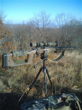

After trying some bags and some comercial rests I decided to make my own universal adjustable one.  I got a cheap, less than 20 bucks, camera tripod from circuit city.   bolted a piece of aluminum flat stock to a tripod puck and wrapped it with the camo ace bandage stuff.   I bent the alum into a "u".  the tripod adjusts for benchtop use and for sitting or prone.  I use it hunting and it has been on a deployment with me too.  It packs easy and is very portable and adjustable, even for uneven terrain, or to get just that right hieght for  "loop hole" sniping.  Great when sitting for 'yotes or turkey also.
this is a pic when i first got it, has been spray painted several times now.  this is as high as it goes which is comfortable for sitting, and it adjusts all the way down to about 8" for bench work.
I also use it for my camera too with the extra puck.  Or the spotting scope.  And it slides easily into the pocket on my ruck.
I have found some sniper rifles to react diferently whether using a sandbag or the supplied bipod, usually bipod worse.  Of course you could put pressure onto bipod front or rear and eliminate fliers....it was just one less thing i didn't want to worry about.  Bags and packs always seem to shift after a couple of shots causing you to either re-find neutral or re-stack stuff.  So I started using my cheap camera tripod consistantly.
works great at the range for my supermag also.   At the public range I see guys stacking and fluffing all types of bags or assembling some plastic creation from a tackle box company.  I whip out my tripod and plop it on bench and then adjust height and pan and tilt whilst getting into position.
I won't lay claim to this idea as mine.  I saw this trick at some sniper competitions and some rifle builders offer them for sale at a very premium price.    I am rough on mine due to not caring if I break it due to its being so cheap....but thus far it has held up to thousands of rounds from all types of weapons from all types of positions in different climates and continents.
If/when I buy another one it will be another camera tripod.
The heavy benchrest comp ones are nice and have thier place, I'm a less is more type of guy though.

Thanks 6.8,  That is an idea I had never heard of, but worthy of some thought.  I like the idea for rifles at least, not sure If I understand quite how you would use it for a revolver??

I use denim jeans pants legs also filled with washed sand for rifle, never thought about it for handgun.
I like the tripod idea, will have to try it.

supermagfan,
i don't know how to post a video here, but here's a link to one i put in my photobucket.
took vid to show diff between 44 and 445 ammo blast and recoil.
the rest adjusts even lower than whats in vid yet, legs can lay flat on table spread right out.
i have used an auto in this rest also with no problems.  hope this explains/displays how it works for me on bench.
http://s232.photobucket.com/albums/ee121/6point8/?action=view&current=CIMG1412.flv

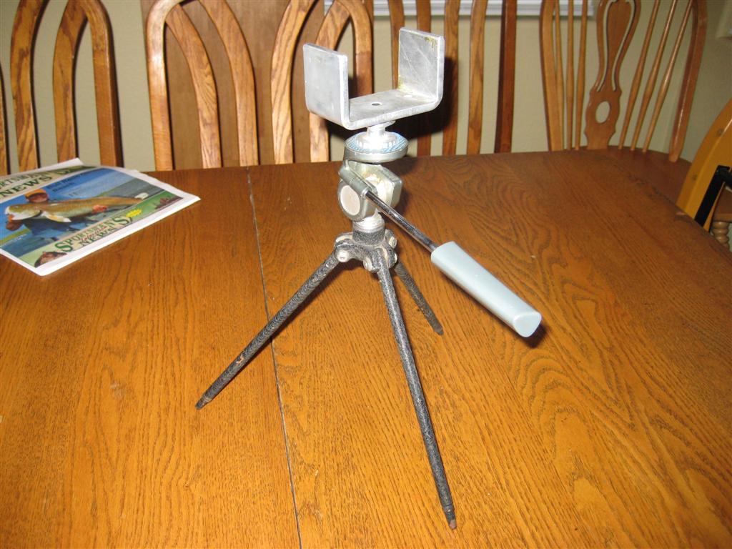

OK, here they are .... finally.  Sorry for the quality of the pics, house is still a mess and it's snowing outside.  First pic is one I made about 20 years ago--1/4" aluminum flatstock bent into a U shape.  I have it on a pan/swivel head and a steel tripod.

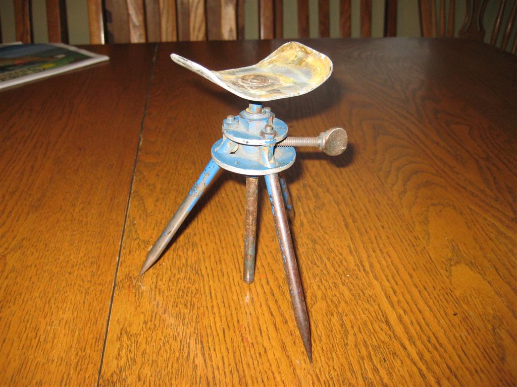

The second one came from my dad a long time ago.  It was made by his best friend a machinist, probably early 70's.  This is one of my favorite field rests--I need to glue a new piece of rubber on it.
