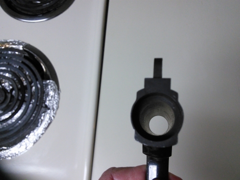

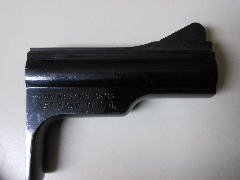

1550893933016_1_IMG_20160102_172128-1.jpgImage Enlarger
2_IMG_20160102_172459-1.jpgImage Enlarger
Pretty sure this is the four inch version of what you are looking for.  Well, slightly short of four inch anyway.
