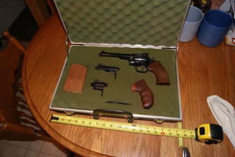

They are pretty much the same size as a standard briefcase. Original W12 Pac cases were different than the later ones. Early ones have square corners & measure about 18 1/2 x 12.

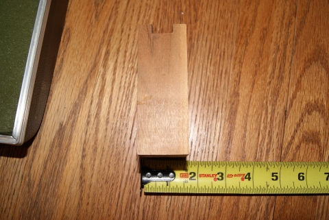

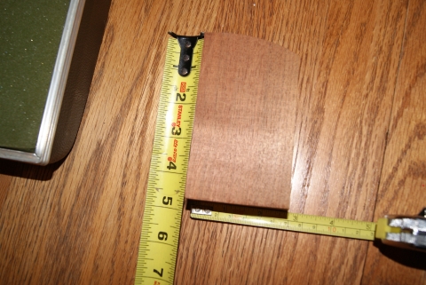

The grip blank measures a little over 4 1/2 x 2 3/4 x 1 5/8. I'm sure you could fudge the dimensions a little & still work fine.

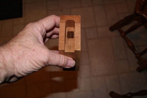

Into the top...

Hope that helps! dwf
