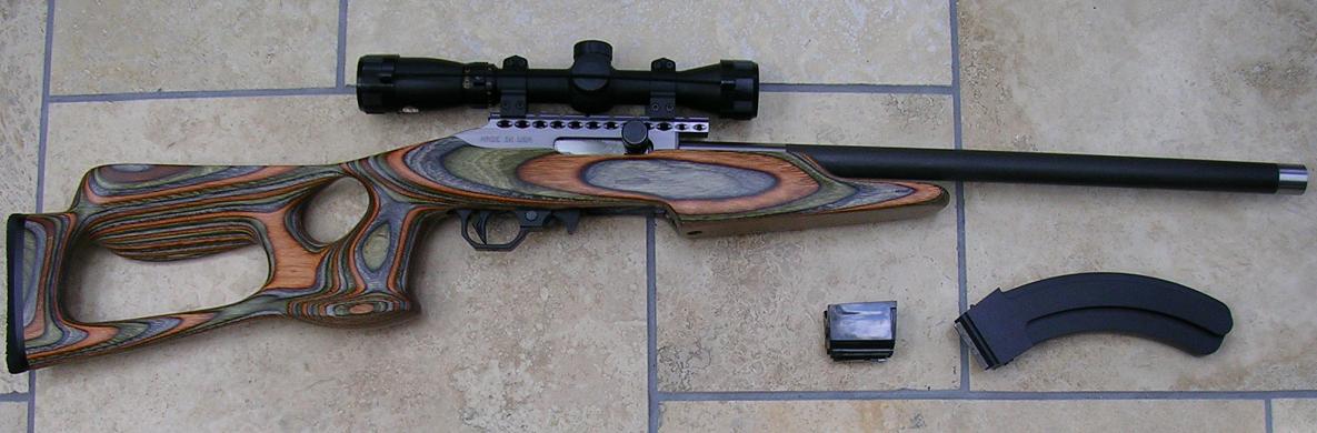

I have a Magnum Research, Magnum Lite .22LR rifle that my wife gave to me as a gift some years ago.  I came across the same issues.  What it came down to is this great little rifle has a preference for the cheap Remington (550 round) bulk pack stuff.  If I do my part, the rifle will run a consistent 1" group at 100 yards with this ammo.  We also have a second one but chambered in .22 WMR and still have not found ammo this rifle likes.
