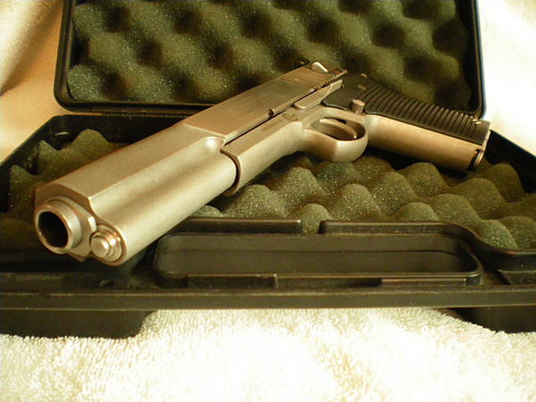

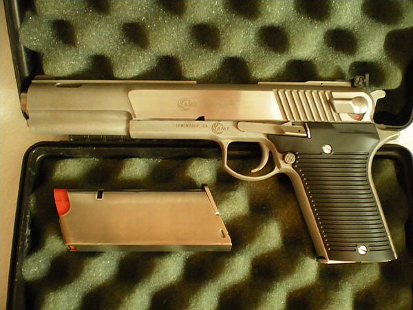

I finally managed to find an Automag V, about year or two ago in a gunshop on consignment. It was still in the original plastic box with a spare mag and the papers. It even still had the serial number tag on the side of the box.
I grabbed it for $900.
I couldn't believe my good luck and I swooped it up super fast. I have been hand loading 50AE down to just subsonic levels just for the gun. My best results so far have been with IMR4227 for a powder selection. I have been pushing 300 grain plated bullets at 950-1000 FPS across my chronograph, and the AMT 50AE is a a real pussycat to shoot at those velocities. It shoots superbly, and will hopefully be around with me for a long time.
Here are a couple of pictures of my AMT Automag V in 50AE.

Cool story about a real cool pistol.  I just learned more about AMT than I ever knew prior to reading your post.  Thanks for the education, makes me want to learn more for sure about these limited unique pistols.
March 6, 2012 - 6:53 am
Sweet deal and not much over the price from years gone by!  I have seen these mostly in 22mag, looked though not very hard!  cool-pics
March 6, 2012 - 9:18 am
Very nice score on the 50AE. I always wanted a set of those Automags in .30 Carbine, 9mm Winchester Mag and 10mm Winchester Mag. Never was much interested in their .22 Automag, it was very finicky about feeding and a lot of them got passed from one owner to the other. I really like the .22LR Lightning pistols, they have better sights and triggers on them than the Ruger MKII's do, and all of mine have been very accurate.
The Backups are very neat, concealable pistols and the Hardballers were decent alternatives to the Colt 1911, but you had to keep them properly lubed. I managed to score an unbelievable gtdw, only in the AMT department, on a longslide Javelina in 10mm Auto. That is a real powerhouse with the old, full-power Norma loads. And I just sold my Baby Auto Mag, a .22LR lookalike to the original .44 Auto Mags. AMT made some pretty cool guns.
