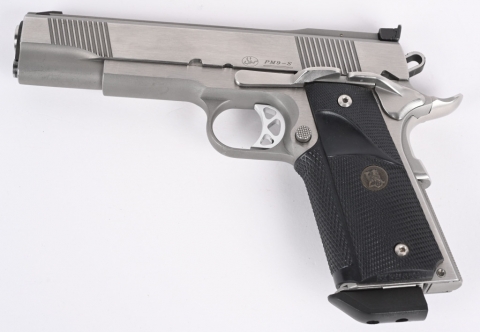

So, I bought a Pre-CZ PM-9-S for my first DW 1911.   Possibly a 2002.   When it gets here (next week?), I am going to want to replace the Pachmayr Grips likely with wood or composite.   Although DW Logo wood grips would be nice too.
First the ignorant question:   How do I determine what grips fit?   Do any of the CZ current 1911 factory grips fit this?
Also would like to replace front blade sight with fiber optic sight.   Keith @ DW, says no current 1911 offerings will swap out on this model.
Anyone have upgrade PM9-S.jpgImage Enlarger
PM9-S2.jpgImage Enlarger
experience with the Pre-CZ PM-9-S?

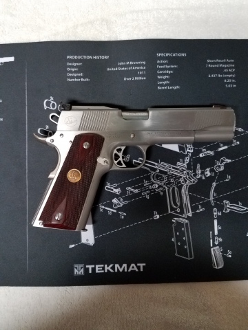

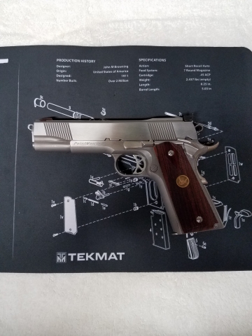

Bad news the front sight is a proprietary cut. Dave Severns used to make a fiber optic sight for these but that was long ago and he no longer does any smithing work. Any standard 1911 government grips will work on your PM9. I am not a huge fan of hump for the Ellison sight and they were known for breakage of the pivot roll pin. They are a very soft shooting and accurate gun. Mine is a two digit on the serial number and is dated 2-26-2003. I don't think there were that many of these made and pretty sure they were all made around the same time. Here's mine.

Forum Posts: 1217
June 28, 2022 - 8:03 pm
1-18-018-1.jpgImage Enlarger
1-18-017-1.jpgImage Enlarger
Those are grips I would put back on, if I could find a matched pair.   My SER# is 0010X, so a few behind yoursdwas
