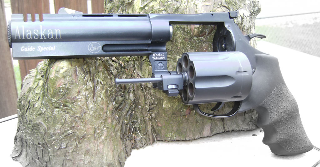

AGS= Alaskan Guide Special, Norwich era 7445 w/ 'Yukon coat' finish; introduced in early '06, IIRC

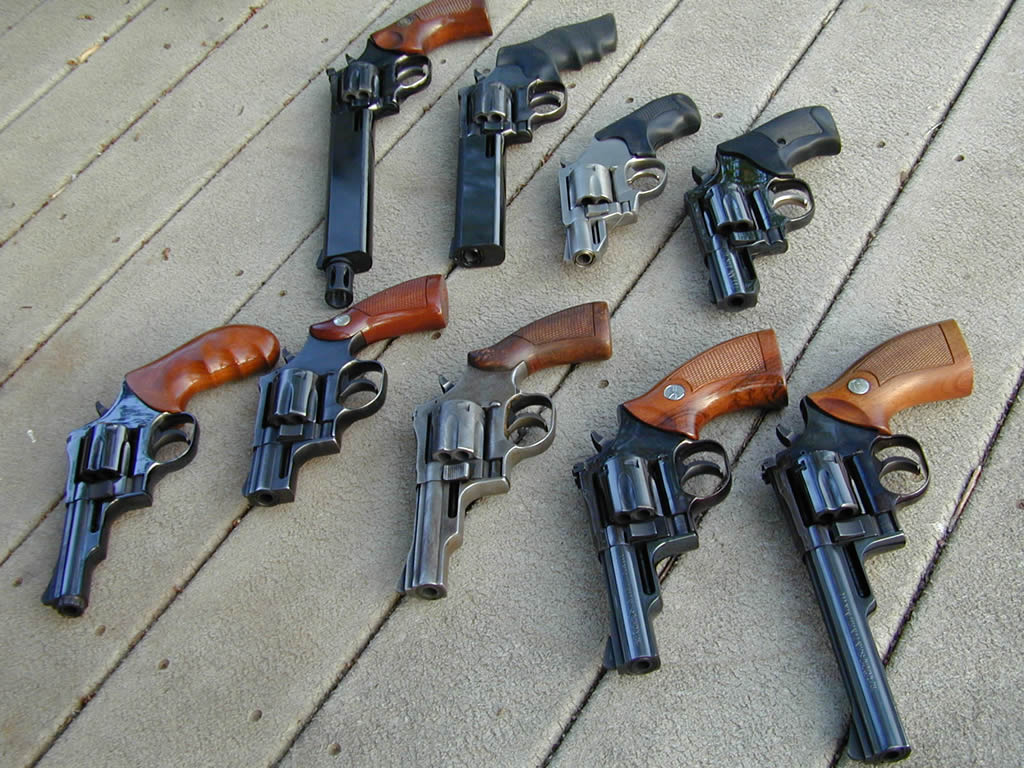

Not telling got a few so still looking for the 32, 22m, 45, and a few others!   Ones I wouldn't part with, Porkies, Mitchells,  Shoot may have the only 709, but I think I have the only Titans!  Well I may sell if the price was right!  dwaspost-pics
so here is one to see!
What are they?
so you all know!  bottom lt to rt: D-11,HS Sentinel 11/2", 14-1,HS Sentinel 111/4", HS Sentinel 111/6"
top l to r: 15-2 w/ 8" EH/flash hider, 14-2 w/EH 6", 738 (Lil' Dan), Mitchell Titan 11 w/fixed 2.5"
