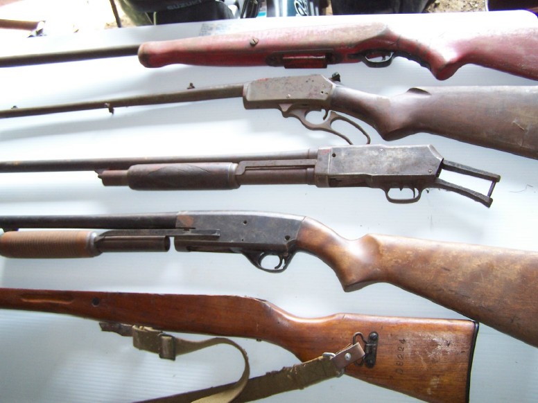

Most probably belong there too. Was over at Uncles, and in his metal out building when I saw these in a trash can. He said he's had them for 20 or 30 years and ment to fix'em up. I ended up with the pile.
Did get a good little Marlin 80. Stripping it down for a make over. It will give me something for the next gunshow.

is that top one a savage bolt shotgun?   I just recently revived one due to it being tossed.  the trigger pivot was all messed up and would drop the firing pin when closing the bolt!  neat.   great turkey blasters.
good catch rescueing those.
February 24, 2010 - 11:13 pm
my money says it is a Mossberg bolt shotgun 😉
6point8
northeast pa
Forum Posts: 157
January 17, 2010
February 24, 2010 - 11:31 pm
ya may be right, clip looks savagey, but stock looks mossy.  clips are prob all the same, built like a tin can.
Forum Posts: 11277
February 25, 2010 - 8:13 am
The second one down looks like maybe a lever action .22?
February 25, 2010 - 9:17 pm
Yep, Top one is a Mossberg Model 195, next is a Westpoint 33 which is a house brand for the Marlin 336. The no stock is a Riverside, did not see a model number. Last is a Springfield 67.  Stock only is a SKS I believe. Marlin 80 should be done in a couple days. bluing is done and bathing in oil. Stock is hung and will get another coat or two of tru-oil.

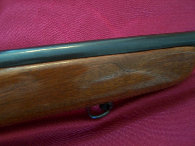

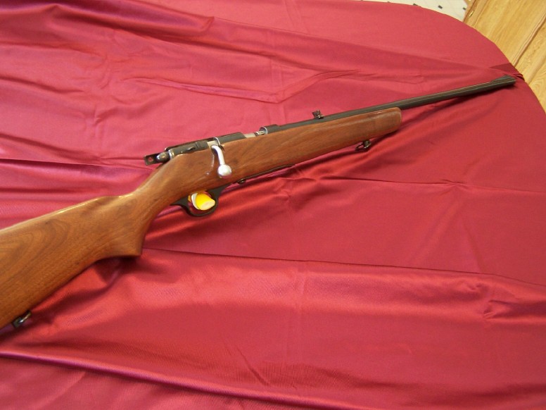

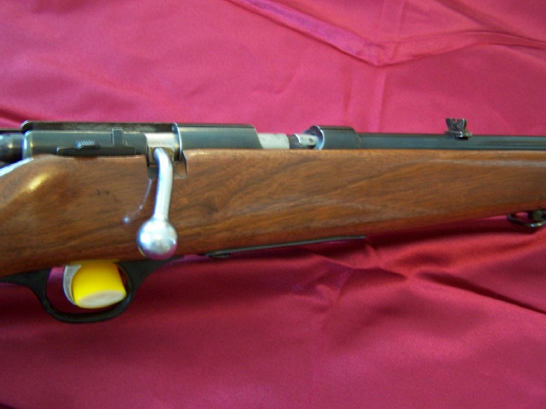

Here's the Marlin 80. I still need to get a clip for it. Shot a few singles through it, everything worked as it should but I need to get a magazine to be sure it function's 100%.

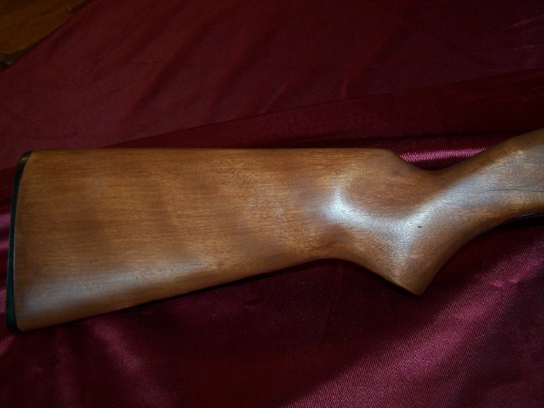

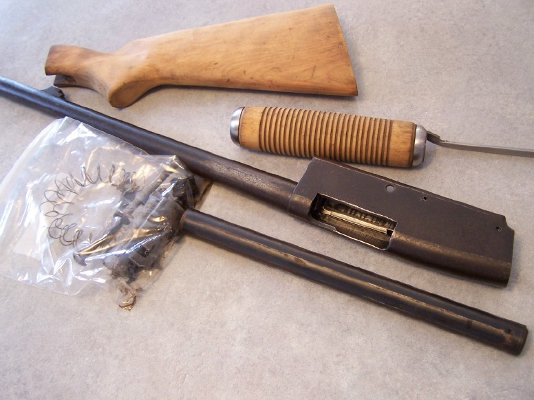

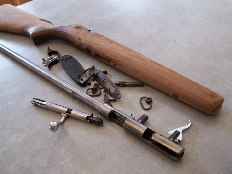

Next I am doing the Savage Sprinfield 67f . This pics is from earlier today, the metal is now in the white and ready for final polish before blue. Wood is getting a degreaser and then to steam iron. Lots of oil stain where it meets the receiver.

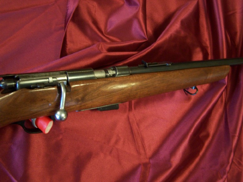

I puchased a clip and some new marlin iron sights from the local shops. Gun cycles flawless, shot a few clips off the back porch. seems to hit good. I will post another pic.

Great, show us some pics when it's done.  Here's the Malin 80 with clip and new front and rear sights.

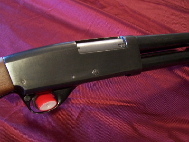

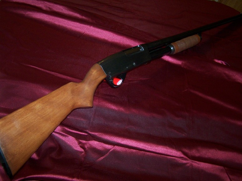

Had to put the Savage 67 on the back burner to deal with family affairs but it's finally done.
