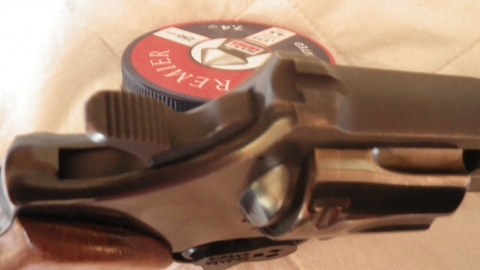

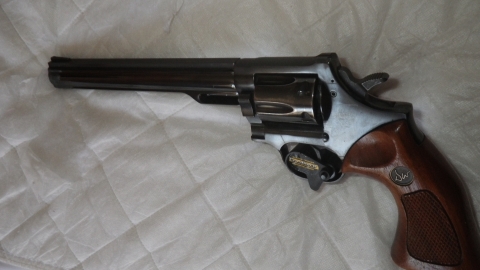

Expensive Education:   Getting back into firearm ownership and replacing what I had before kids.     Last week, I learned the hard way to pay attention to the details.   I bought a 15-2 Pistol Pack from seller, and turns out to be a Model 14(?), based on fixed rear sight, and gun shop employee, that I assume knows more than I.
Which brings me to the question: Do I sell the entire pistol pack?   or sell gun only and buy a 15-2 frame to add to pistol pack?    Add to this question the detail that I already ordered a 10\" barrel from cz-usa.

If the rear sight is fixed it is a model 14-2, assuming it's not a pork chop gun.  In that case, it would be a 14.  15 and 15-2 have adjustable rear sights.

Beware sellers, gun shop employees, and gunsmiths concerning Dan Wessons. Most long time forum members are extremely knowledgeable about Dans and will steer you right. You now know the seller and gun shop owner are ignorant but rwsem and Scorpio are among the most knowledgeable. If your gun is a porkchop or a fixed sight gun or both you should demand a refund from the seller. If it is, a fixed sight 14 a 15-2 frame will not shoot accurately with the shrouds. If it is a porkchop 14 your 10" BA coming will not fit the frame without an EWK adapter if you can find one and the 10" will still not shoot to point of aim.
   The logical conclusion if you don't get a refund is to buy another correct 15-2 pistol pack and enjoy both. goodluckdwas

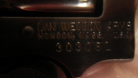

I appreciate the information.   Updated original post with pics.

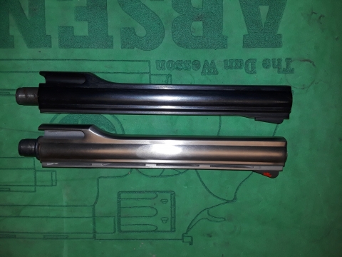

Scout, as Ron said, that's a 14-2.  The 15-2 shroud will fit, buy you're going to need to play around with different front sight blades to get it to shoot to point of aim.  The 15-2 shrouds are taller and sit higher when attached to the frame.  I'm going to try to post a pic of a 14- and 15- side by side so you can see the difference.
December 26, 2020 - 3:16 pm
Sorry, my phone inverted the picture, can't seem to rotate it.
Anyway, the pic shows a blue 14-2 8 inch shroud and a 715 8 inch shroud, the same as a 15-2.  Note the top rib differences.  See how the blue one is lower at the frame end than the stainless.  They will both fit either frame, but the sight heights will be different and thus the point of impact.
