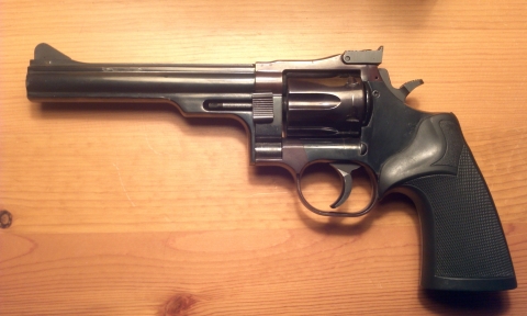

Im looking around to add a porker and need to educate. Anyone willing to add pictures to this thread and explain what it is would be great. I want to get a porker but do not want to mistake and buy a franken gun.
1.Dan Wesson Collectors: Model 14 Pistol Pac .357-img-18
This one has a dove tail sight,is this the only frame for a M-14
2. I see this that someone is calling a M-14 but it has a straight shroud and no rear sight to speak of

I'll attempt to answer some of your questions about pork chop Dans, and if other members find incorrect information they can educate us both!
Photo 1. is indeed a Model 14. The rear sight (and its corresponding front sight) is very high due to the thickness of the rear part of the frame. It would have a recessed barrel nut.

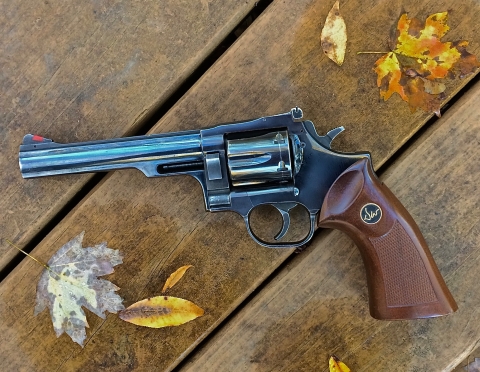

The photo I'm posting is of my Model 15-1. It has the thinner frame of the later models and corresponding lower sights as well as the recessed barrel nut. Also, it has the cylinder crane latch of the later models (15-2). Not visible in the photo is the longer hammer throw more associated with the 15-2. Models 8,9,11,12,14 and 15 have a shorter hammer throw. Some folks feel that they are more accurate because of this feature. The grips on this gun are from a much later DW. Hope this helps.

Looks like I am after a 15-1
I dont really like the height of the front sights on the 14- 15's in my pictures but do like the sights on yours.

The 14-1(fixed sight) and 15-1(adjustable sight) were only made for about a year (1974) so they are not as plentiful as the 15-2. Not exactly scarce, but you might not find one the first time you search. The internals are basically identical to the 15-2 and are interchangeable.

  It is important to make sure when acquiring shrouds that you don't mix 14, 15 and 14-1and 15-1. Front sights are taller on the earlier model. You can always file them for a - 1. The reverse though is a problem.

Will any other newer grips 15-1/15-2 fit on the 14 in picture #1 ?

I believe that all the sma
l believe all small frame DW grips with a square tang socket will fit.  Aftermarket grips made to receive the square tang of the small frame DW will also fit.
