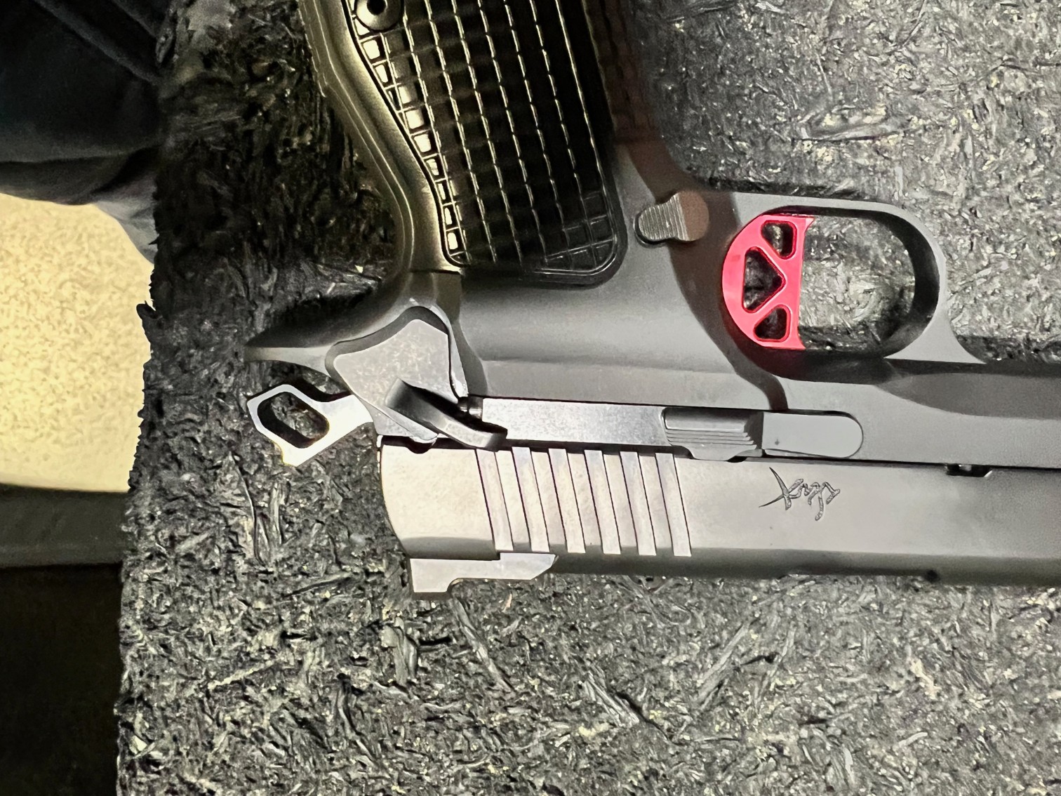

I took it back up to the range today and was not able to duplicate the shell extraction issue, which may be a good thing.  I also wasn't shooting that dirty Herter's ammo from bass pro.  Actually it was 100 each of Herter's and S&B that I brought the other day and today was 100 each of Maxx Tech and Magtech today.    The issue that continued today is the safety seeming to creep up while I am firing it and appears to eventually to interfere with the slide (internally?).  The gun is making it to battery but the hammer is not all the way back, about 90%.  I can either drop the safety, which kicks the hammer forward (without firing the loaded round) or I can pull back the hammer the last 10% and then drop the safety (it seems about halfway up at this point) and that will let me get back to firing.  I have enclosed a picture of the pistol when it jams...
On another note... The previous owner claimed the gun had not been fired before and I trusted that it hadn't.  It did perform flawlessly for the first 400 rounds or so the weeks after I first purchased it.  Again though, I trusted he was being honest.

Falling to half cock is dangerous you're very close to going full auto. Maybe/probably the thumb safety is contributing to this malady??
Does the thumb safety function as it should when on?
Can you remove the thumb safety?
If so check that the plunger is free moving in it's tube then if so you may have to deepen the recess
notch in the thumb safety so the plunger catches it better.
