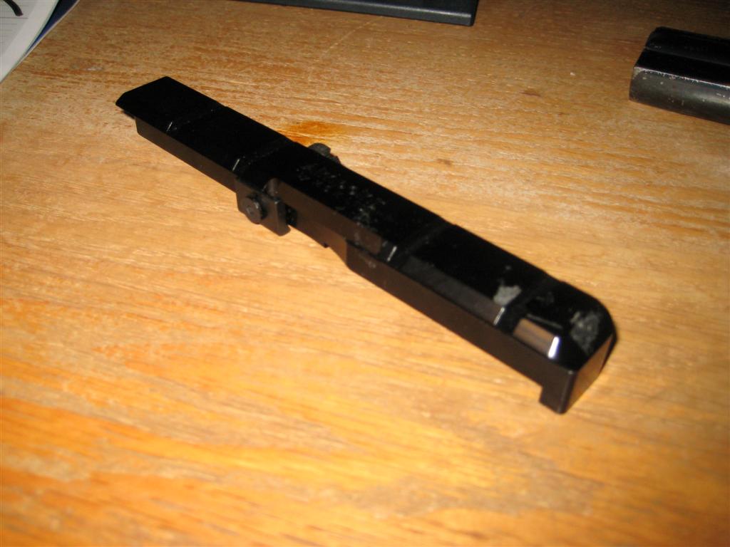

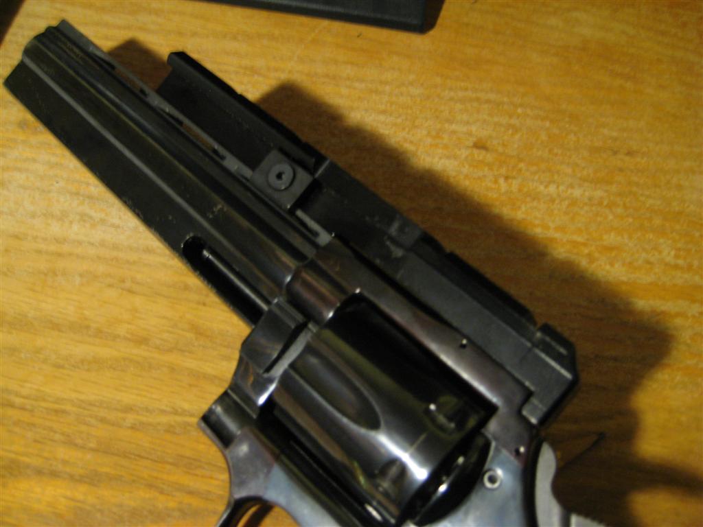

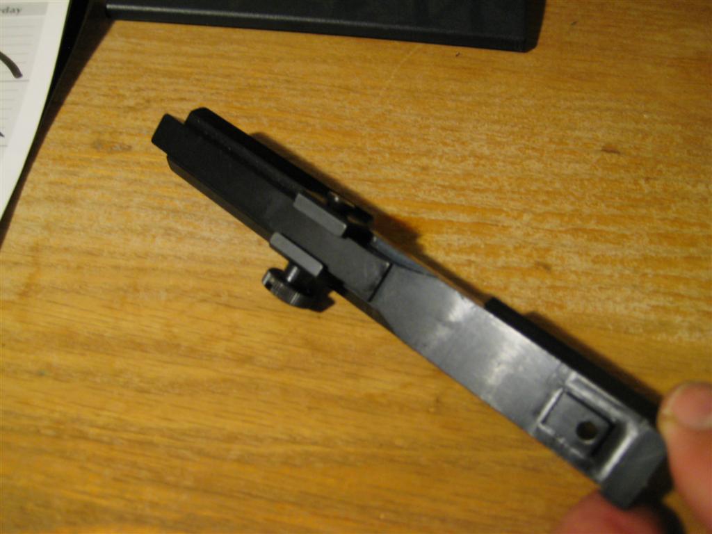

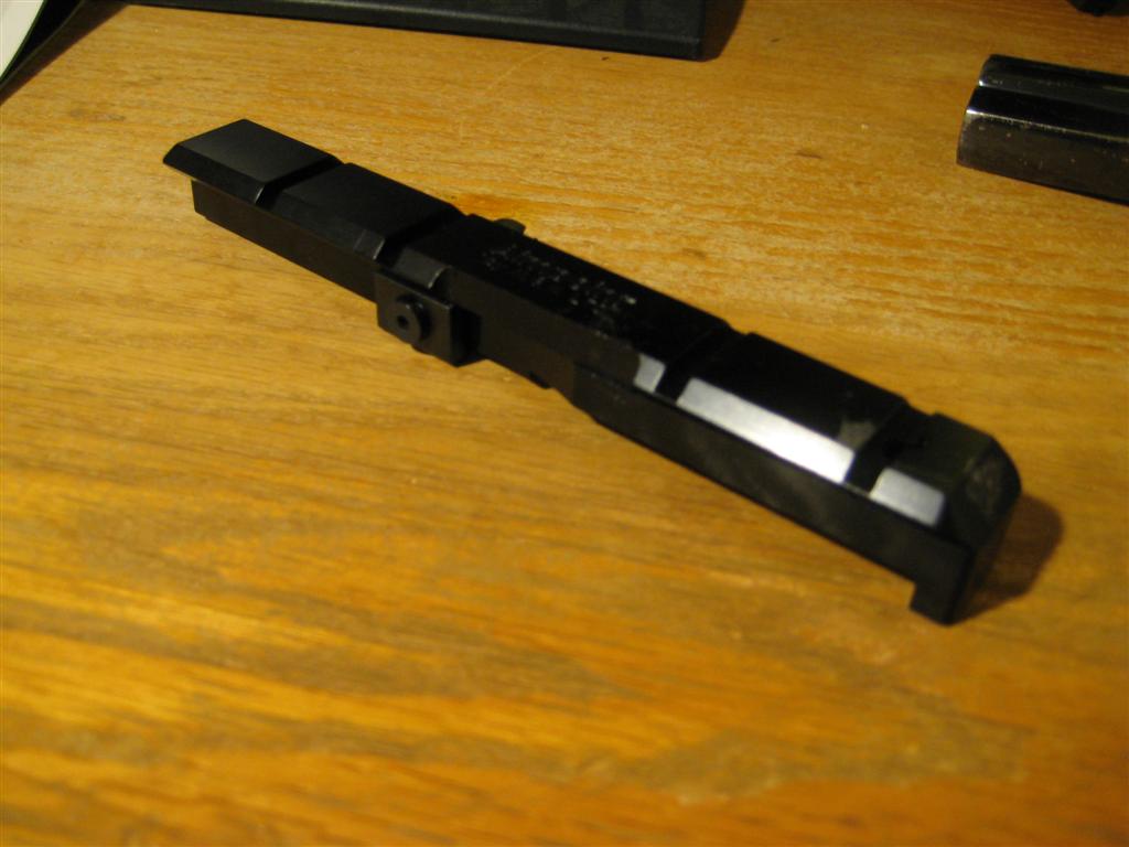

September 20, 2010 - 10:44 pm
ok, first of all...sorry for the crappy pics.  It's late, it's dark, and the mount is black...
bolts in rear sight and clamps on the rib with one screw.

September 21, 2010 - 3:01 pm
Ah, thanks for the aimpoint pics shoot! That is interesting with the clamp that goes on the shroud, the only downside would be having that to take off when changing shrouds...what we were thinking is just to keep the mount on the frame thus allowing seemless changover between shrouds.
Maybe what we could do is for an extra long picatinny rail, offer the shroud clamp on those? That would help support the extra "overhang"
