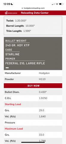

Are you using Rifle Primers?
They are stronger than other primers.
This is my question as well.
445 requires a large rifle primer according to the Hodgdon online data
