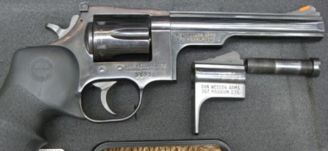

April 25, 2025 - 9:16 am
IMG_7192.pngImage Enlarger
Like Ole Dog said, when the barrel assembly is detached, the part protruding downward looks like a pork chop bone.

I’m wondering if our friend is referring to the crane latch needing replaced. The model 12 and 15 have a different latch, and he may be trying to replace with a 15-2 one, which won’t work. Photos would be very helpful.
