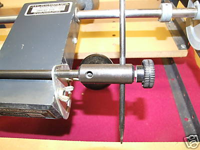

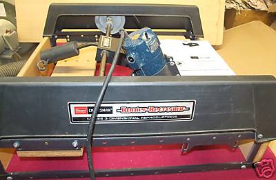

Just picked up a new toy off of eBay.  Its a Craftsman Router Recreator.  Hopefully I'll be able to use this to make so grips for my DW's.  I think I have figured out how to do the inletting and will give you guys an update once I get the new toy and start playing with it.  Now I need some wood!

Looks like my Router-Recreator will not be here until next Tuesday! Cry  I think that it will do most of the inletting work for me.  I have some ideas on how to do it which will require making a couple of jigs.
We'll see... I'll keep you guys posted.

I've been under the weather since Friday and haven't touched it!  I'm hoping to play with it this week.
I need to pickup a new router to go with it so I don't have to unbolt the one from my router table.
I'll keep you guys posted!
