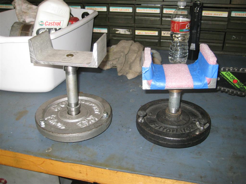

How about under $5... wink

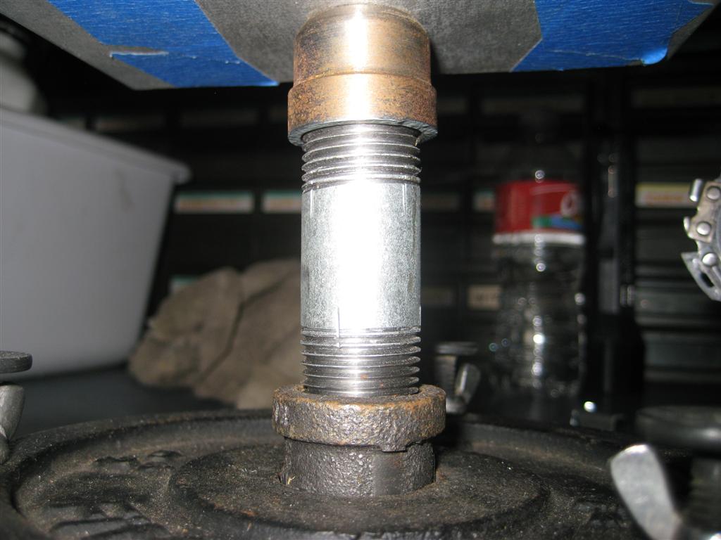

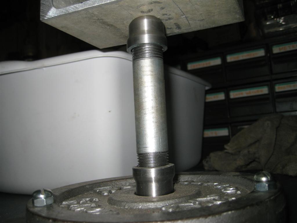

I built these for my kids because none of my rifle rests went low enough for them to use properly.
Weights from the goodwill, a few pipe fittings, and some Aluminum U channel from the shed...
If I need to make severe height changes, we just change the pipe length.
One of these days I'll get them painted up and attach the leather bench bags.
That's a great idea. There is always a cheaper and efficient way to do things. The more money you save on these things the more money you have for ammo.
