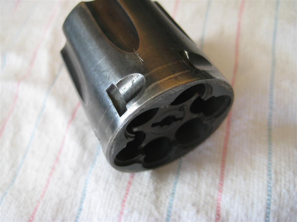

Once I had a beer and took a hard look at the gun, I noticed the crane was bent so bad the cylinder was binding on the inside of the topstrap.  Blue is all wore off rear end of cylinder.

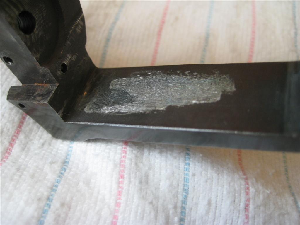

Some genius decided the best way to fix it was to grind away the topstrap...

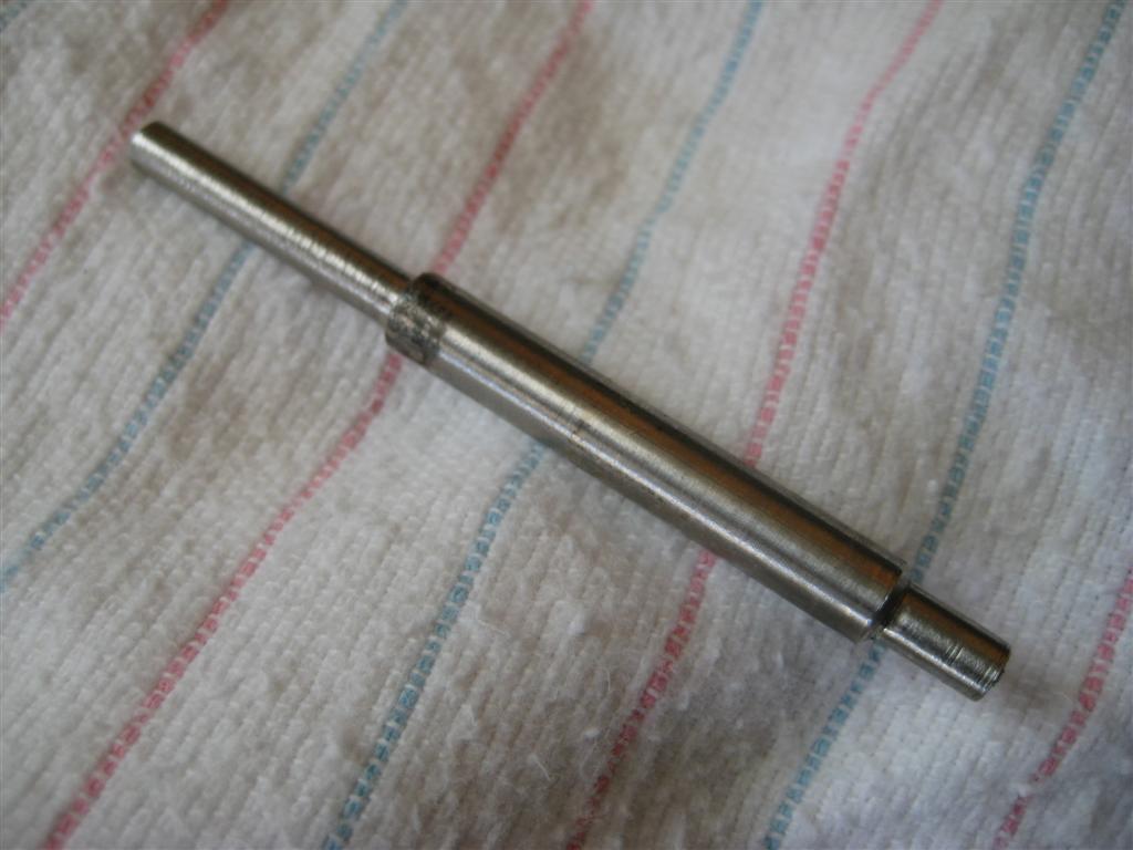

So I fired up the lathe and made a gauge to see how much it was really off...  the answer was half the diameter of the cylinder ball hole.

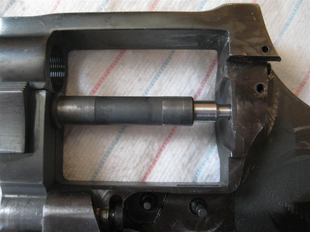

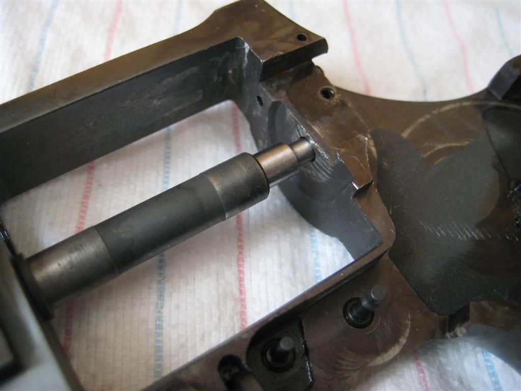

 So I made a jig to bend the crane back in shape...
 the result laugh
As you can see, she lines up perfectly now.  I'm going to give it a quick reblue and tune it up.  Should make a "nice beater" when i'm done with it.

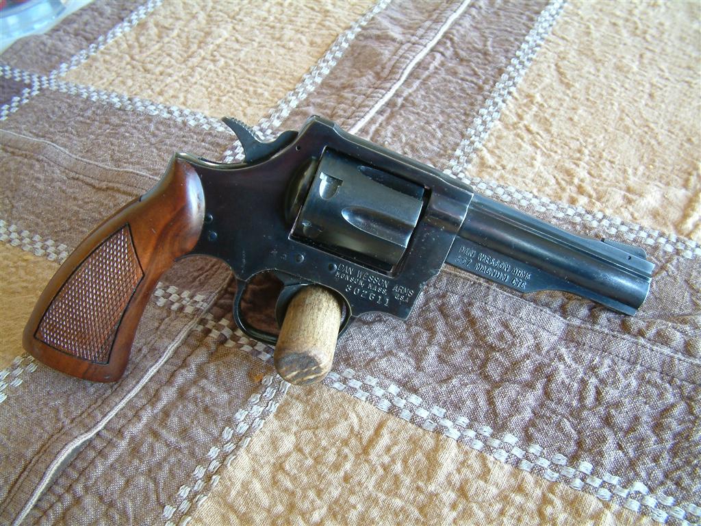

OK--She's done occasion
I'm not sure which I enjoy more--just buying DW's in general, or getting to work on them...  I really do love working on the guns and making them the best they can be.
This one has the crane repaired, a quick Oxpho blue, tuned and lubed...  Should make a great trail gun.  She won't win any beauty contest, but she's as smooth as smooth gets !!!
