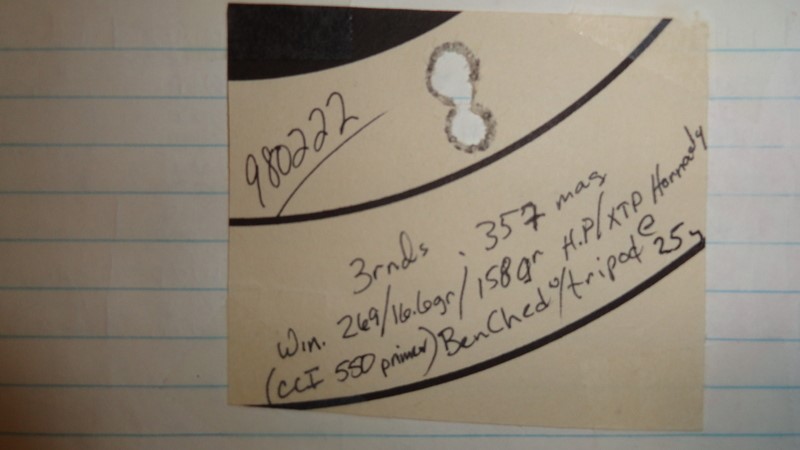

I like a 158 grain Hornady or Nosler jacketed bullet with 13 grains of AA-9, standard powder, any brass.
Seat to the cannelure, use a Redding Profile Crimp die.

 I wont give my load with 2400 powder and 180 gr XTPs but it works. I have figured out it hates anything to do with my cast wadcutters but my Smith loves them, in any load. Thankfully the Dan seems happy with my cast 124gr (130) round nose, 9mm but the 9 is giving me headaches.
