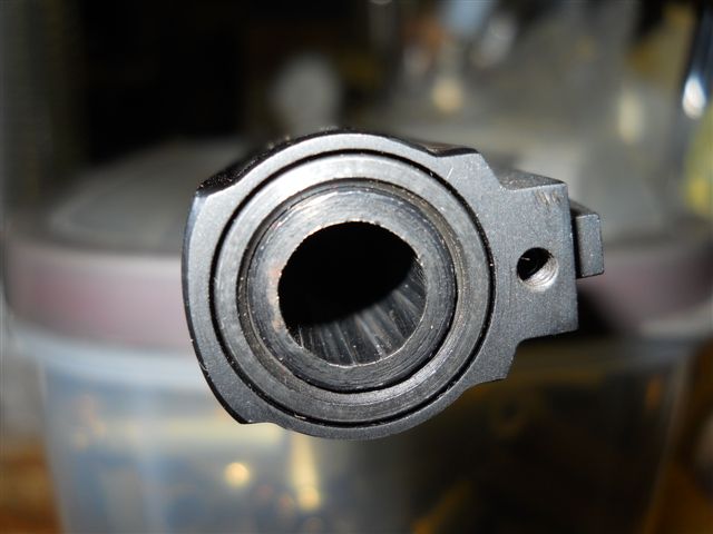

Hello, i picked up a used 10" blue barrel and schroud, the barrel nut does not have any nocthes to use the barrel removal wrench, can someone tell me whats going on here?. thanks George.
October 23, 2010 - 5:14 pm
Pics would help a lot... I don't think they made a 10" fixed barrel, but who knows.  No notches on either side of the nut?

No Notches on either side, George. I could send a pic to someone if they would post it for me.

I'm intrigued--PM sent.  You can send pics to me.
October 24, 2010 - 3:05 pm
unless the nut is flipped over, this is a fixed barrel I guess... waiting for George to answer me if he can remove the barrel from shroud.
October 24, 2010 - 4:27 pm
How dose one remove fixed DW barrel from frame  ?
October 24, 2010 - 6:02 pm
George:
It's been my experience, IIRC, that there is no visible nut at the front of the shroud of a fixed barrel gun.
I think SHOOT may be right that the nut was put on bass-ackward.  Careful use of a cold chisel and hammer should start it rotating for removal.
With a barrel vise, which is standard procedure for most all other brands, I believe.
Here's the end of a Fixed Barrel M15...
Forum Posts: 5421
October 24, 2010 - 7:07 pm
You can tap on the forcing cone end w/ a mallet enough to expose the nut and grip w/ (protected) pliers.  I just tried it w/ my 41 spare barrel and shroud. A squirt of kroil or other lubricating oil between the barrel and shroud may help...

October 24, 2010 - 8:59 pm
Yes,
I agree, if this is just a shroud, barrel and nut...the spanner slots could have been smooshed upon removal at some point, threaded on backwards and driven into the shroud. I know mine the barrel nut fits very "perfect?" in the recess in the shroud. I would put an old sock or a rag over the muzzle side and whack it firmly with a mallet at the cone end, if the hole she-bang lets go the cloth will keep the barrel and suspect nut from flying accross the room.
If it's on the gun, I would use a good ice pick device and keep it as on center of the backwards nut while in a barrel vice and reverse it out like that.
I used the pointed punch to remove the cloverleaf wheel nut-locks on a Vette with aluminum wheels using this technique.
Just a thought.
YOH
October 24, 2010 - 10:09 pm
Is the pic that SHOOT posted George's barrel ?  If looking at the rear end of barrel
turn/twist clockwise would loosen nut and barrel ? Previous owner had to have
tightened this in the same but reverse manner.

The nut was put on backwords, got it apart and everything is just fine, thanks for everyones help, George.
