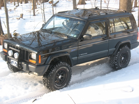

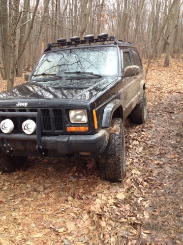

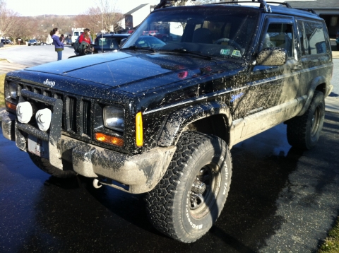

   I do know a little about Jeep Cherokees, I  own a 1997 2-door which I have had for over 14 years. In my biased opinion the XJ platform is awesome. They possess ruggedness, simplicity, & reliability. There are still thousands on the road so parts are easy to come by, and there is a strong aftermarket support. If you look at a potential one to buy, look underneath for rust. Even here with PA winters it is possible to find relatively rust free examples in the price range you quoted. Leave the rougher ones for the offroaders. I would agree '97 or newer, the '96 and older is fine but they are getting so old that nice bodies are difficult to find.
   Mine has only rusted on one rocker panel, which I had replaced with a NOS part just this summer. The only reason it rusted thru is because the little vent quarter windows leaked and let water run down the inside of the body. I would suggest avoiding 2 doors, their production #s were much lower and so parts are becoming difficult to find. Also if you haul people the 4 door is just more practical.
   The 4.0L inline six is an excellent engine, good for 250K or more if it has been maintained. Ridiculously tough. We have a Wrangler with the 4.0L that my step daughter wheeled into a swamp, water up over the hood. Pulled it out, drained the oil, pulled the spark plugs and cranked the water out of the cylinders. Dried the plugs and put them back, refilled the crankcase with oil, it started right up and ran like a top. It makes plenty of power for the XJ body. A little rocker arm noise is normal. Gas mileage is not its strong suit, but is not bad until you start adding a lift kit and big tires. The 5 speed manual trans is very durable. I believe the automatics are also well regarded, perhaps a little susceptible to overheating if you wheel it hard.
   My Cherokee has 156,000 miles. It is now a second vehicle but I still drive it regularly. I would not be afraid to hop in it on a 1000 mile trip tomorrow. When my daughter turned 16, it became her vehicle for 4 years and survived. If you are an average amateur mechanic like me you can do a lot on these rigs. Unlike modern throwaway suvs, the Cherokee front suspension has grease fittings, a couple pumps at every oil change and you are good. And the local auto parts store has most of what will wear out or need replaced.
   I hope this is helpful. Here are a couple pics-
