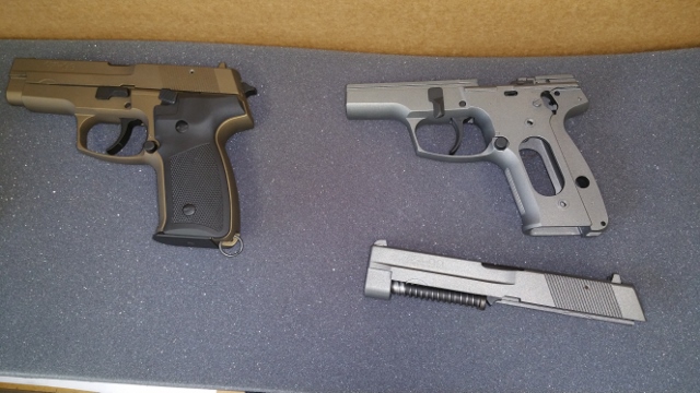

So I go to help them out on Tuesday, with the CZ's and then there are also, some FN- Browning Hi-Power knock-offs which I disassemble in short order then I look at these 15 CZ's, they are almost identical to the Sig 229, only difference is the Mag release assembly and the main spring shape and location. Piece of cake... Well, the mag release turned out to be a real kick in the keister, but I got'em by jacks.. Wed. I am putting things together and Fed Ex shows up, and the Manager Truman, says hey take a look.  Two pallets, Glock 17, 19, and 23  chambered in 9 para and 40 S&W.  They strip the slides and disassemble the slide to coat the color of the formed frame Glock.  I been in heaven all week.. I am going back next week to help put all the Glocks back together from the second April shipment... Now check these out...20150422_132000-640x360.jpgImage Enlarger
 These are a sampling

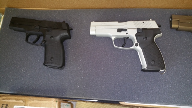

of the CZ. The first is called Patriot Brown. Grips and action parts went back to Gun Black. The Second, I hadn't finished is Tugsten. The bottom row first one of course is Gun Black and the next, is what they are calling their stainless. They name is Aluminum Metallic, IIRC, thats what it is. I had on my flash so it turned out white in the photo, but it is a very nice Stainless look for real.

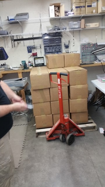

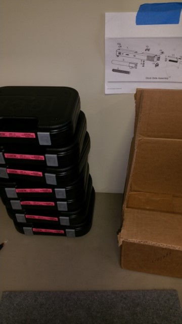

 2 pallets like this, a total of 740 Glocks.
Their second run this month. They said next month will slow down because of the new Mod 43 and another, which I forget. Sad sometimes getting old. But the new models will start only Black.

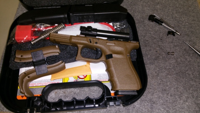

10 guns in a case. I was helping them out here as well. notice the slides in the plastic container.

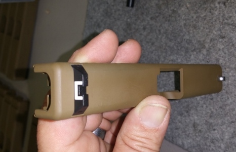

Then below is a Gen 4  23 with the slide removed and the separated components to the side, ready to be bagged and place in the gun box. The slides will then be coated to the Austrian Dark Earth to match the frame. Now I may have mentioned, I am not such a Glock Fan, I won't tell ya I was more than a little impressed by this operation.

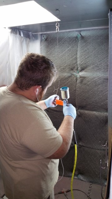

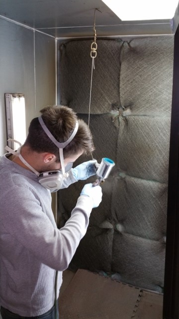

Next is a couple of shots with some guys spraying the color before they go to the oven for 2  hours at some crazy temp. Sorry I forgot the oven pics but they are huge and each rack they have to go in there hold a 100 parts jigged to hang.
  This first guy is spraying an Orange that a customer wanted on
their Glock grips. A walk in.. and then The other guy is actually spr.ying the Glock slides. I will do a photo update next week of the finished slide so we can all see how they turn out.

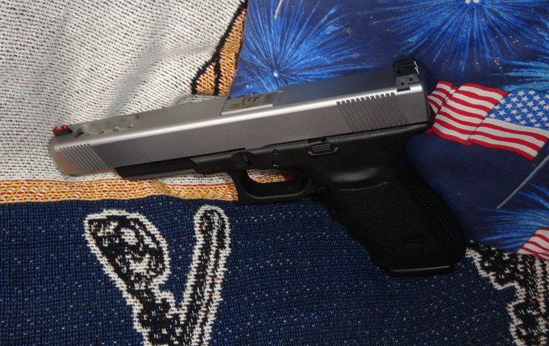

Small Glock fan, myself... here's my 10mm long slide that I built:
DSC01482.JPGImage Enlarger
April 26, 2015 - 9:19 pm
That looks pretty good Ron. I was telling those guys I may have to pull the slide off this new M&P I got for Anniversary and Have that stainless look added. Now I've seen a "black n white" it does have an appeal.

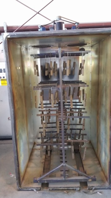

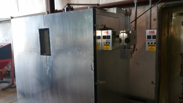

 Ok so here are a couple shots of the ovens, full, about 80 here.
Those racks will hold about 200 slides. However, to keep them from clinking or sticking, because of the fans inside, they do about 80 or so in the small oven and about 150 in the large oven.
20150427_134512-640x360.jpgImage Enlarger
They bake for a little over 2 hours at 200 hundred degrees. This makes the stryker shaft sleeve shrink and not melt out. Other pieces will bake at 320 for about 40 mins.

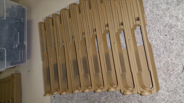

Next are some slides colored and I have them lined up at my work space to start reassembly.
20150427_100906-640x360.jpgImage Enlarger

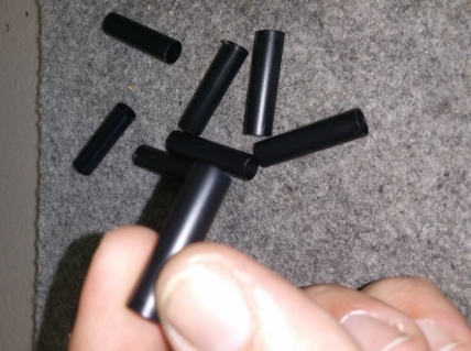

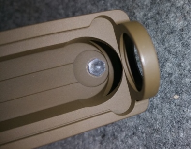

Now they have a plastic sleeve in the stryker shaft that has to be replaced, that is a pain to remove until it has been heated, the sleeve has then shrunk. I pull those with a o-ring hook and place a new one in the shaft.
 Plastic, but has to be driven in.20150427_100947-640x360.jpgImage Enlarger
20150427_101003-640x360.jpgImage Enlarger
They will only work one way, but they will fit either way. You can kinda judge how deep by the insertion tool.

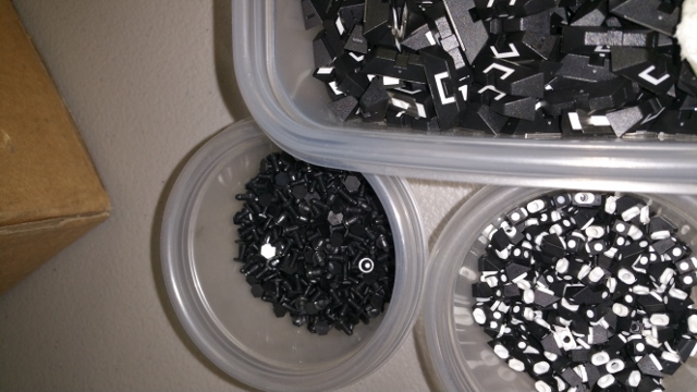

Next come the sights.  20150427_103620-640x360.jpgImage Enlarger
The rears came in that box corner in the shot. The box is about 18" sq. Same size with those sleeves, though there are 6 attached to a ring. the front sight and it's screw came in boxes about 10". Truman said he thinks they are 10000 to a box. That little tiny screws filling a box is pretty darn heavy.
 Drive in the rears.
The fronts pop in a slot and then get a tiny screw.
Sorry not clear I tried to magnify a little. The little driver there is magnetic.

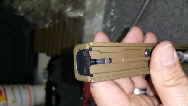

 Then I am ready to put the extractor and safety plunger back in. The stryker and the stryker keeper. Funny to say cause I usually would say firing pin keep, if 1911..  I didn't take a shot of the completed pistol;. Don't know why???? oh well, another day for that. Slides are not quite as dark as the frames but they do look nice. I really got work on my picture taking if I plan on telling another story.... I will finish the shots for ya. That is pretty much what goes on there. I may not be much of a Glock fan, but I sure am becoming acquainted with this gun... Who Knows???

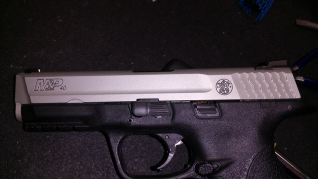

Ok  Ron, Here is my cerakoted M&P slide. They did a super job I think and I just said a stainless look to fit the gun...
shots are with the overhead fluorescent lights on and then under flash.
20150507_125343-640x360.jpgImage Enlarger
20150507_125416-640x360.jpgImage Enlarger
That kid Ethan is a genius with a tooth pick on the lettering. Told ya I was kinda diggin' the black and white look.
