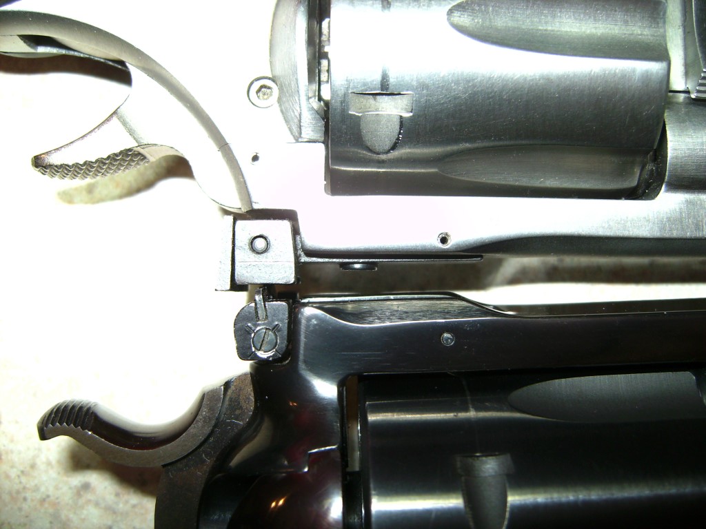

Man that pic to a few to figure out!!!  Now we kow what you do in your spare time!!!      cool-pics
August 9, 2011 - 7:57 am
Old photo from a previous discussion.  I was drinking Guinness beer that day….occasion  Been a while now.  Here's the other one:

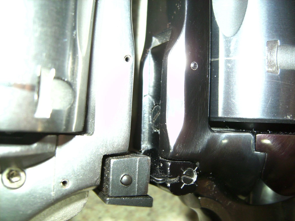

For a short time, DW used Ruger style rear sights on the 15-1 Porkchop. (and so did the HS Sentinel MK III)  The main difference is that it's squared on the bottom, by the sight blade, as opposed to Ruger's half-moon style. (sorry about the blurry picsembarassed)
