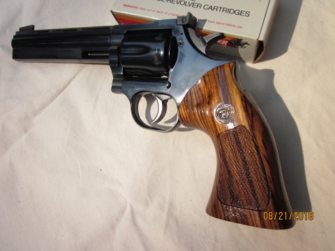

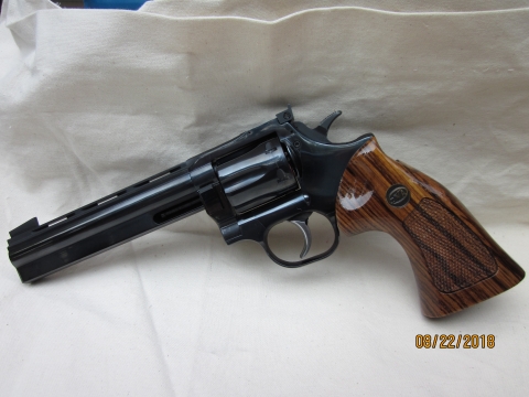

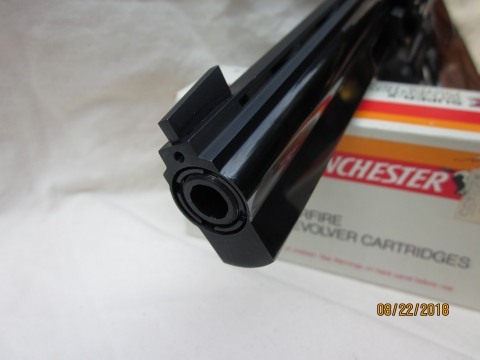

Here is one that has been a safe queen since my ancient FFL days. 176XXX serial range. Bought in late '78 or early '79. I polished the trigger, installed an NOS late style checkered hammer, an EWK Patridge front sight blade and 4 slot barrel nut. I guess the Zebrawood stock qualifies as an upgrade, as well. I very judiciously stoned the full cock notch on the trigger, and polished it and the hammer nose with a Dremel/Cratex bit. Smoothed all internal contact points with oiled 600/1000 wet or dry, then polished all with crocus cloth - including the trigger return spring slot. I used crocus cloth on the spring itself, the OD of the hammer spring and the ID of the hammer spring seat. If you look closely, you can see the flat socket head overtravel screw that I installed to stop the trigger from peening the frame with the tiny OEM set screw. Re-doing the scruffy white outline on the rear sight blade was nearly the most labor-intensive of all. At some point, I guess that I will actually have to shoot it!

Very Pretty!worship
Now we need a range report.big-grin
Thank you. And right about that range report!
