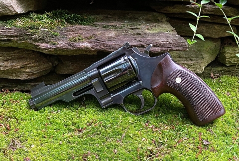

Well, I have created some really nice looking Dan’s lately by swapping out various frames, barrel assemblies and grips. I put this one together with what was left over, and while it surely isn’t pretty, it does what DW revolvers are famous for: wonderfully tight groups way out there.IMG_1576-1.jpegImage Enlarger

Wow. I think it is a very good looking revolver. And even better, you say it's a good shooter.  I believe all revolvers look good, DWs even look better. big-grin

Thanks, Steve. I guess it’s really not that ugly, just an unusual group of components. 15-1 frame wearing a W12 barrel assembly, but a patridge front sight installed. The grip is powerwood, which was not DW’s best idea. Still, my trip to the range this morning verified the superb accuracy of this setup.

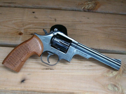

Looks pretty schweet to me! cool But I may be a little biased, I definitely have an affinity for most any variation of DW Porkchops...especially the "ugly nut crowd". Long ago, before I owned my first one, I said "those guns have a face only a mother could love"! lol2 But then I really fell in love with those ugly ducklings.  Being a 15-1, I bet it runs really great. I love my 15-1, although the cylinder is the most finicky of all my DW's, it does NOT like to (more like absolutely will NOT) chamber my reloads! So far I've been kinda butthurt. cry But it is just fine with absolutely any factory load...I really need to figure out what I'm doing wrong, all my other .357's are just fine with my reloads. Pretty sure it's in the final crimp. Anyway...
What did you use to refinish the Powerwood grips? Looks really nice from here.
My 15-1, the picky little bugger!
HPIM2746.JPGImage Enlarger

I definitely hear you on the tight chambers of the 15-1. Mine is the same way. Spent cartridge cases from any of my other .357’s will barely start in if I try to insert one. I haven’t reloaded for about 35 years, so I only shoot factory, and have had no problems. As far as my powerwood grip is concerned; I never refinished it, it looked just like that when I purchased it off eBay a few years ago. Its unique color is not very attractive, and I’ve never seen another one that looks like that. Your powerwood grip looks great! It seems that some of them have the tiny W medallions and some don’t.

My grip is actual wood, not Powerwood. If I recall, the gun came to me wearing a rubber Pachmayr. In 2009, fellow member Shootist357 found the grip somewhere...shown in post #15 HERE. I bought it from him in 2010 for my 15-1 because it was unique & to me it looks fairly period correct. At the time, he was thinking it was an actual DW grip, but I'm not so certain.
Interesting that your Powerwood is how you found it. Like you, I have never seen another one in that color, very interesting.

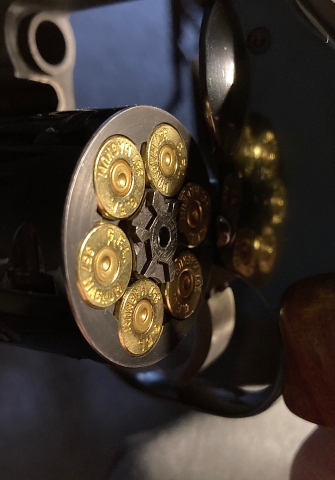

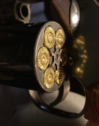

Just a couple of little things to add to this thread: The only “tight chambers” are on the 15-1 as far as I know. The W12 chambers are not tight, but are recessed a little deeper than the later guns, so case heads are usually flush with the rim with cartridges loaded instead of protruding a bit. Also, the extractor rod is noticeably shorter on the W12 (and also the corresponding relief slot on the shroud) which means that a W12 shroud won’t fit a 15-1 unless you swap out the rod.

Would like to see an example of a W12 Chamber...Just for edification...tho it ain't gonna change My tight Chamber situation..
Again..If I do Not use Nickel Winchester Brass...the situation abates...and if I Use Unplated Brass period, I have Far less Problems with My MKIII

This shows how the depth of the chamber recesses differ between the W12 and later DW’s. Also, the chamber throats measure .358 on the W12, and is the only DW .357 that does as far as I know. This would be beneficial to cast lead shooters since it would result in less barrel leading.IMG_1301.jpegImage Enlarger
IMG_1300.jpegImage Enlarger

I , in my ignorance, simply rolled the model 14/15 Pork Chops in with the Exposed Nut ones.. Never considering other differences...Now I know..

Actually, the exterior nut models, 11 and 12 (also 8 and 9) are basically identical to the 14 and 15 except for the barrel nut and the 14 and 15 barrels being 1/4"  shorter. The 14-1 and 15-1(HS Mk11 and 111) have different sights, different cylinder latch (the modern one) and they don't have the short hammer throw trigger. There are some other very minor differences too. I am also a Pork Chop lover. My bedside gun is a nickel 14 with Wolfe Springs that has one of the best and fastest DA  trigger of any revolver made. The combination of nickel, short hammer throw and Wolfe Springs is magical.
