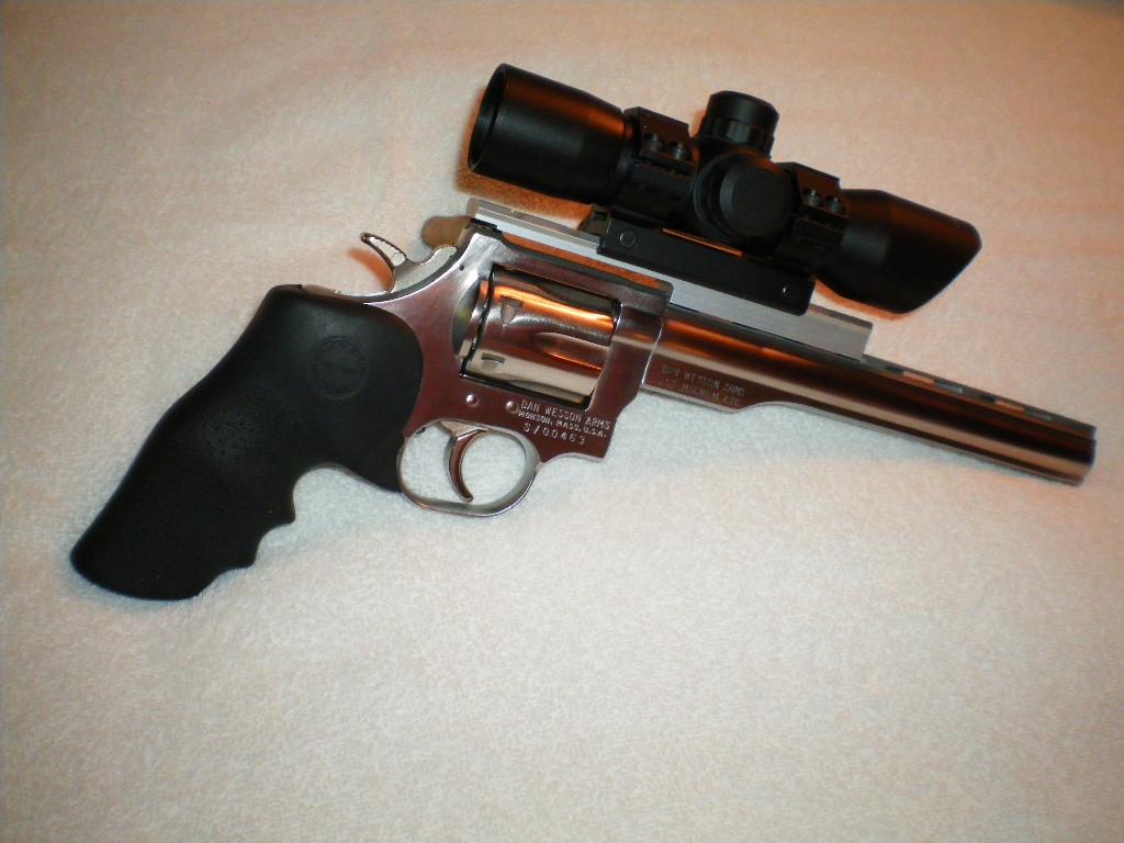

I mounted a scope on my 714's 8 inch shroud.
Now I need to take it to the range and sight it in, to see if i like it or not.
I am including a picture, because I know we all love pictures. Sorry gang, but I'm not the best photographer.

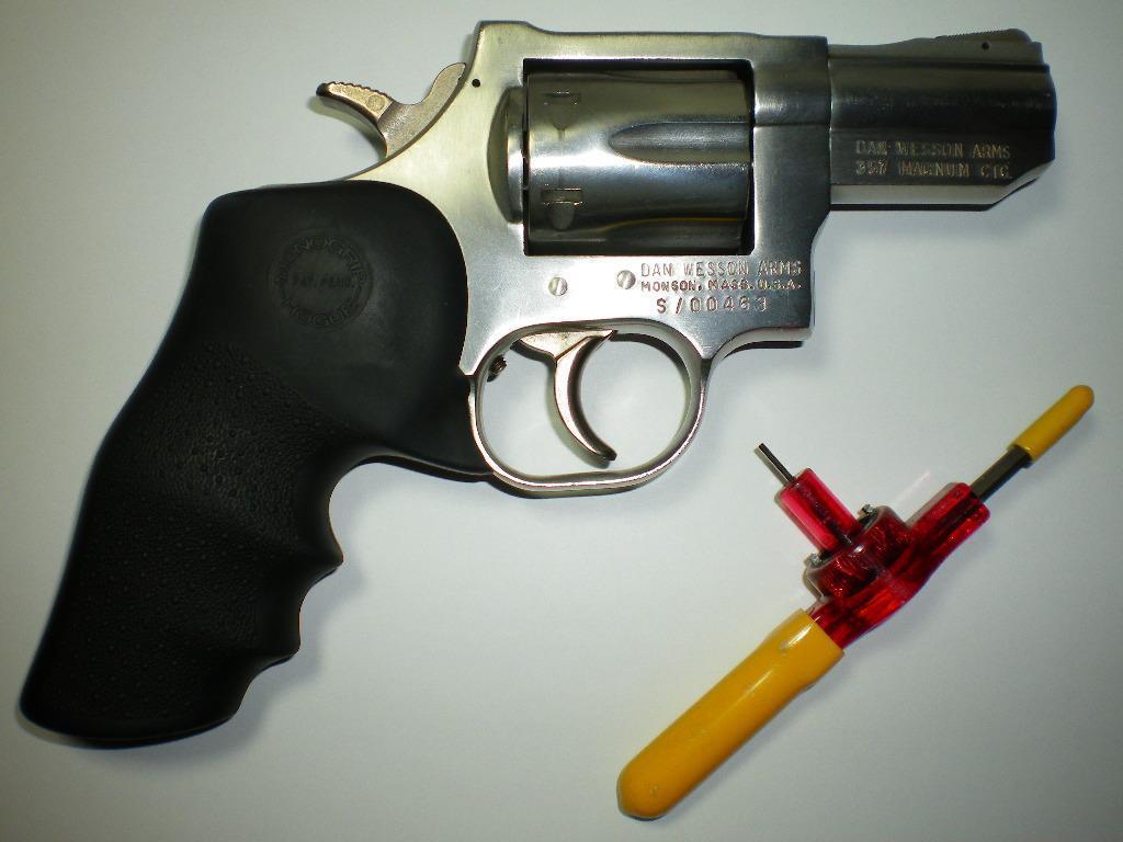

2-inch-714.JPGImage Enlarger
Here is a pic of my 714 wearing the original 2 inch 714 barrel assembly that came along with gun. I used to have the box for the barrel assembly, but that was years ago, and the box has long since worn out and been lost. Sure wish I had kept it now.
The 2 inch barrel assembly in the picture is apparently for a 714 from harly's description.
I have a few 715 shrouds, and a couple of EWK conversion model 14 front sight blades as well, so I can use a model 15 shrouds, on a model 14 gun. (or 714)

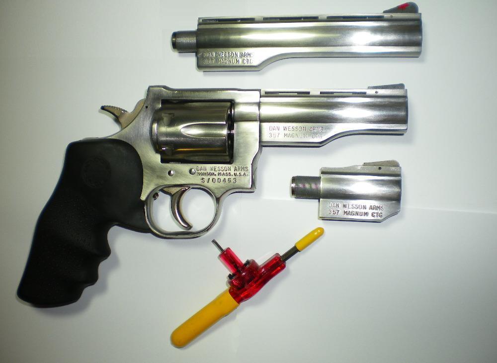

Here is a picture of 2, 4, and 6 inch barrel assemblies next to my 714.
Dan-Wesson-2-4-6-inch-barrels.JPGImage Enlarger
The 6 inch barrel assembly is a 715 shroud with a standard model 15 sight blade.
The 4 inch barrel assembly is a EWK model 14 conversion sight, on a 715 shroud. (and is mounted on the gun in the picture)
The 2 inch barrel assembly is a 714 barrel assembly, with a model 14 sight blade.
You can find EWK Dan Wesson Model 14 Conversion Front Sight Blades from the link below.
http://www.ewkarms.com/zencart/index.php?main_page=product_info&cPath=9&products_id=17
Typical weight .38 spl ammo shoots to point of aim on my 714 with an EWK model 14 conversion sight blade installed on any of the 715 shrouds. The stock 715 sight blade is too tall for the fixed rear sight on the 714.
