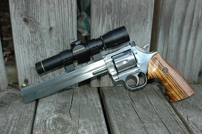

Gents,
Received the rings and did a quick assembly. The Brownell - Warne rings appear to lock onto the rail and fit nice. Once I get the scope adjusted exactly where I want it and do a final torque, then to the range for a sight in. I really don't expect any movement or sliding of the rails or scope, this seems to be a pretty robust ring. As a side note for your reference, these are the high rings with a 2X Leupold, probably could have went with the medium height rings and still clear the rear sight?
-Greg

From a guy that has tried a couple of time to scope a DW,
That looks excellent, a medium ring might work, but I think your setup looks very good as is.

Looks sweet! Do the rings have the recoil lugs on them?
I think the High rings are a good choice-bet the Med. would be hitting the rear sight, or close to it, but the looks of it.

Hey Eric,
Yes these rings have the recoil lugs and fit within the rail slot nicely. Still havent got to the range to sight-er in yet. Too much work and not enough play time latelty cry!!!

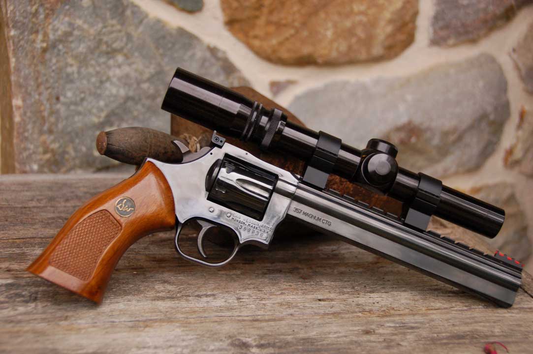

Got my rings from Brownells (thanks Greg OH!).
The QD rings without the recoil lugs did not work.  The rings kept moving forward.  The ones from Brownells worked like a charm.  No movement at all with 38s or 357s.  No change in point of impact even after heavy loads.
Here are some pic.  Of course the most important one is the one at the bottom.  These are 25 yards from a rest (I wish I was good enough to do that offhand, maybe in another life).  This gun/barrel combination is the most accurate handgun I have ever owned or shot (except for my TC contender, but they are't really handguns, just short rifles).
One thing that really suprised was the difference in POI between 38 wadcutters (148 gr and 2.6 gr Bullseye) and 357.  The factory 357 were a full 3" lower at 25 yards.  The heavy barrel really helped to tame the heavier loads, though.  I'm going to have to work up some accurate 357 loads.
