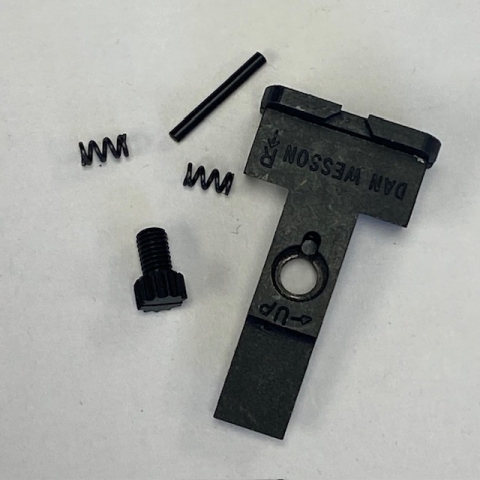

Is this part specifically for a large frame Dan Wesson, or would it fit and function in a small frame 15 VH?
Dan Wesson Revolver rear sight assembly, Silhouette models #1043-RS-3D1043-RS-3D.jpgImage Enlarger
October 12, 2024 - 4:55 am
I am not really familiar with this sight or model number, but by the placement of the elevation screw it looks like it will fit the small frame revolvers also.  I believe the Hi Viz Ruger revolver rear sight should also fit the small frame guns.
If you're interested in a Blackhawk sight without the logo which will fit the small frame guns (for cheap), send me a PM.

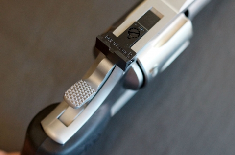

We'll see, so long as the front blade can be made to compensate for the taller rear, I'll be happy with the resultant sight picture. No, there was no markings like "Millett" or "BoMar" or even "Italy" or "LPA" on the body anywhere. Just what you see up top; Dan Wesson, Up & Right. Look at the newest pics of the CZ era Dan Wessons 715s, I think it might be that sight, made for CZ by somebody in Italy or such? (I mean, why the need to put "Dan Wesson" on YOUR companies sight, otherwise?) Looks like I DID sacrifice my "all Allan" wrenchability, and I'll have to include a fine flat blade screw-turn to crank on it to chase my incompetence around the target board... laugh
found a pic of a newer CZ made Dan Wesson 715, showing THAT rear in place, little hump down, "Dan Wesson" and all...

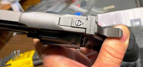

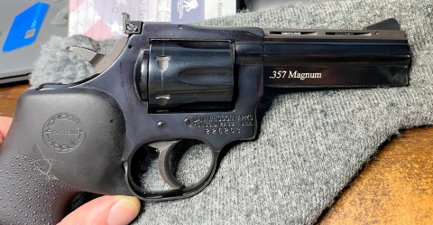

Here is my Dan Wesson, with that same rear sight (from Jack First) installed;

Like I said, only concern will be the front blade height required., might need to be taller?
October 18, 2024 - 3:01 am
You are correct, it's the sight that was used on the latest version of the 715.  I didn't even think to check it - I thought the sights on the latest 715 guns were plain without markings.  I just verified it - it's the same sight.

And I just walked back in from running two cylinders full each of .357 125 gr and .38 125s, and both shot precisely to point of aim at 15 yds with that rear sight one click off of being bottomed out, and a plain black ramp front sight. There goes any concerns I might have had about the rear sight blade being too tall. Nope, it's too "Perfect"...
