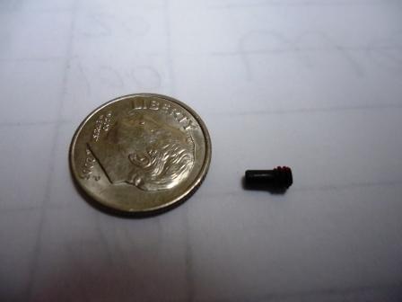

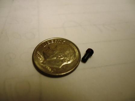

new rear wilson sight ordered todaysmile
i did notice this which i really think is wrong....my 715 just has a allen head grub screw.  can anyone tell me the size so i can order one.
i noticed when ejecting a case it is impeading the travel.
http://i1126.photobucket.com/albums/l616/als1200/SANY0132.jpg
Forum Posts: 5421
May 27, 2013 - 8:51 am
I would recommend taking the screw out to take with you to a hardware store.  The threads may not be original to the gun anymore.  Hopefully you have a good hardware store close by...
May 27, 2013 - 6:46 pm
Definitely not original. The screw that retains the cylinder release is a VERY small screw. I notmally use a jewelers/eyeglass screwdriver
May 27, 2013 - 9:47 pm
I looked again at the first pic and saw it showing there (the screw head) it cold be large head screw so pop it out see what you can find to fit flush or internal! Oh and BTW the Dan is 15-2 a 715 would be in Stainless!   Show us that FB!

My 715 has a screw like yours, can't say if it was original or not, as I purchased mine previously enjoyed, but it works. Most of my Dan's have a screw like this. On the parts break down it is shown as #23 latch retaining screw. Numrich has them.

Thanks for that.  It works dont get me wrong but i noticed that the ejector rod tip fouls on it and i can only imagine that in a speed event ejecting (quickly and cleanly) the cases might be a problem.  only assuming at this stage.  the plan is to get it either reblued or painted with Cerakote so i will get it all sorted before thats done.

i found this link (i would think most would have) and it looks like it should be a roll pin going into the crane to hold the crane latch in place.  was there changes inbetween with some screw some pin?????confused
http://dwcollectors.org/dwca-content/manuals/disassembly_small_frame.pdf
May 29, 2013 - 8:38 am
I believe the early models 14s and 15s or before had a roll pin. The dash 2 era all have screws. Someone with the pork might can verify that.
May 29, 2013 - 9:42 am
I did have one -2 gun with a roll pin, I always guessed that someone lost the screw and replaced with a roll pin. Every one I have pulled apart in that area has had the very tiny screw, however.

Well undone the screw (damaged) and the thread in the crane still looks fine.  i had a couple of side plate screws with the allen key head and reasembled it.  Heaps better.  now the ejecting rod bottoms out with out fouling.  Very simple idea that works well.laugh
