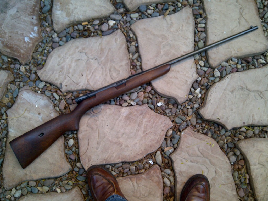

It's true, there's nothing like bringing any neglected piece of equipment back to working condition. The problem these days is first finding the fixer upper then, when you have found it, getting it for a reasonable price. I have a nice old (65 year old) Winchester Model 74 22lr autoloader that I got for a $100, it just needed some some TLC on the bolt mechanism, and some linseed oil and wire wool treatment on the stock.
It's a sweet little shooter.
