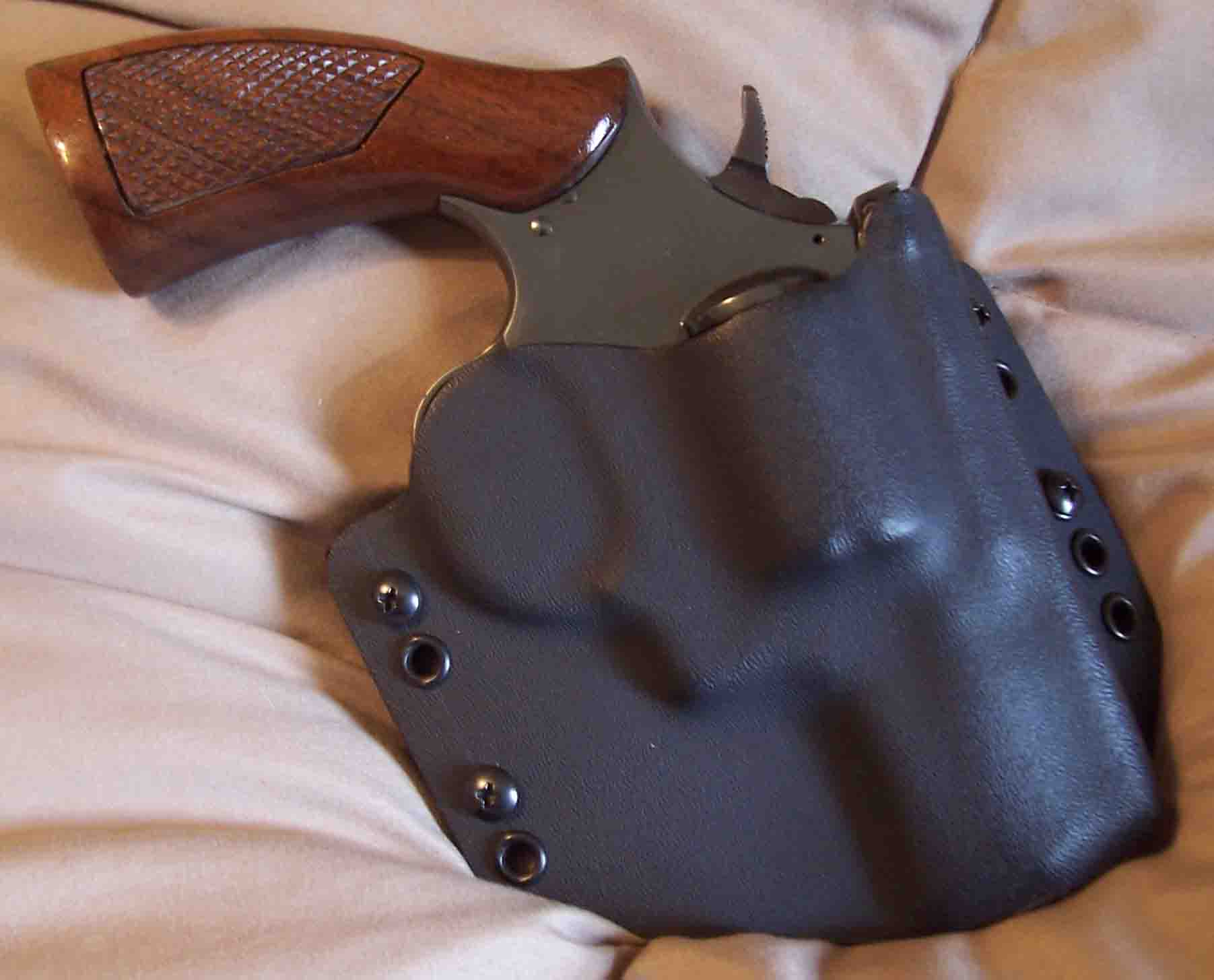

  Alright guys, I lost my camera on a trip with my lady to Chicago, took a while to buy a new one.
Here's my 15-2 I purchased from Gunbroker earlier this year. I got fed up with Ebay's prices and bought a 2.5 from CZ. Fits great. I also got a "Custom Diy kydex holster" from Evilbay. I used a toaster oven, power drill and a makeshift foam press. The Dan shoots great, a bit heavy for conceal carry but I'm a bigger guy and after an hour it gets pretty comfortable. Only gun I have so there's that too...Hope you guys enjoy!DSC03670.JPGImage Enlarger

Very nice job on the holster.  Carry, shoot, carry shoot...... It won't feel heavy after a while.

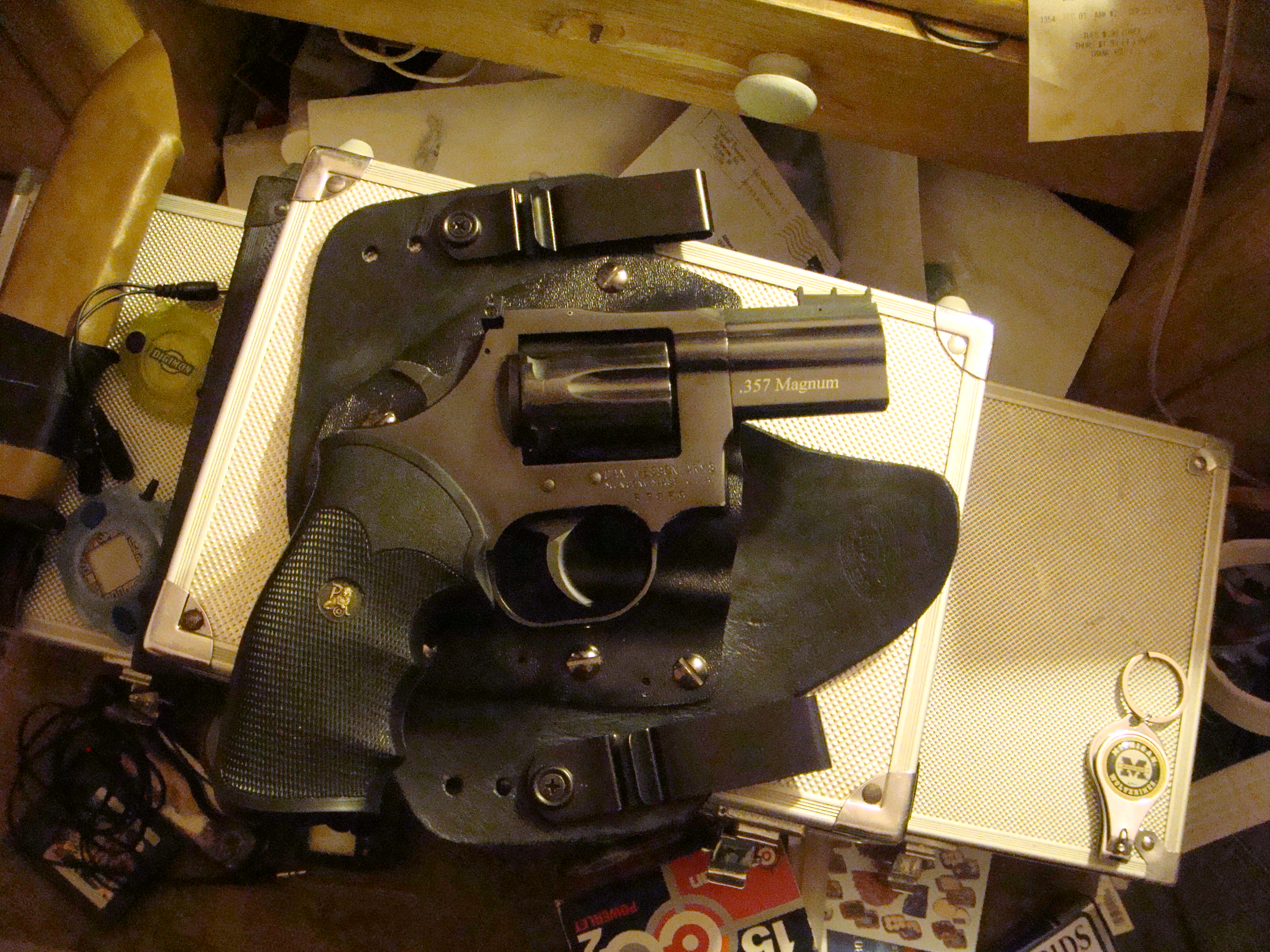

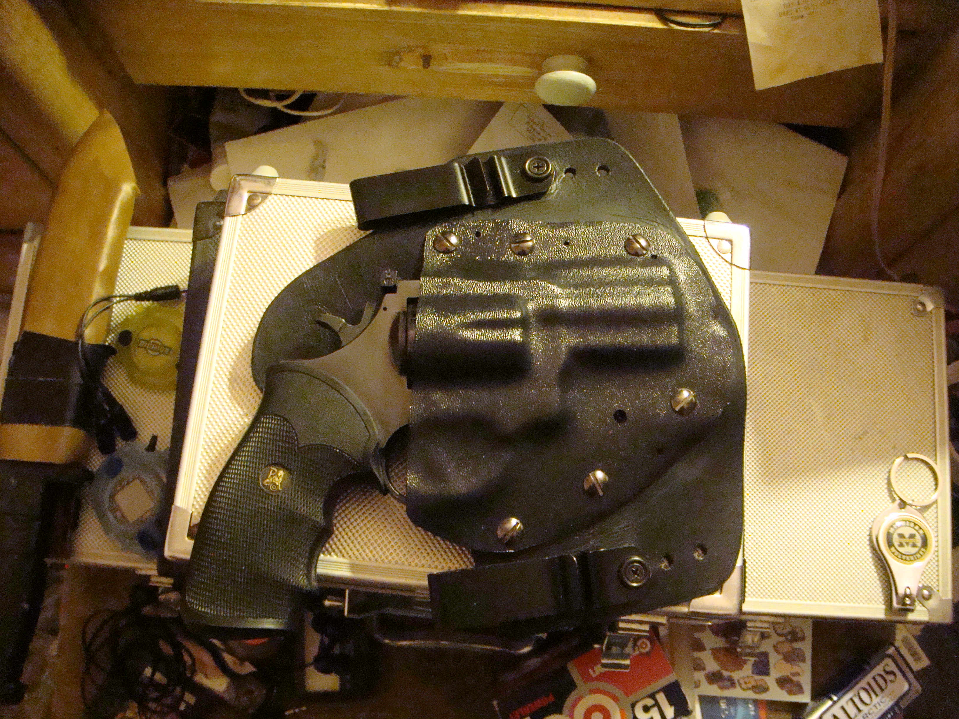

Thanks guys, at first the holster was really tight, but it broke in pretty well. I was worried about the retention getting too loose over time so I drilled one extra hole an inch under the muzzle - If I needed to tighten it, another chicago screw can be added. The tandy leather screws really are something! I'm still very new to the holster game. I am planning on making a full kydex hip holster when Eric gets more EH shrouds in stock. I also have a misguided kydex hybrid shoulder holster idea in my mind...

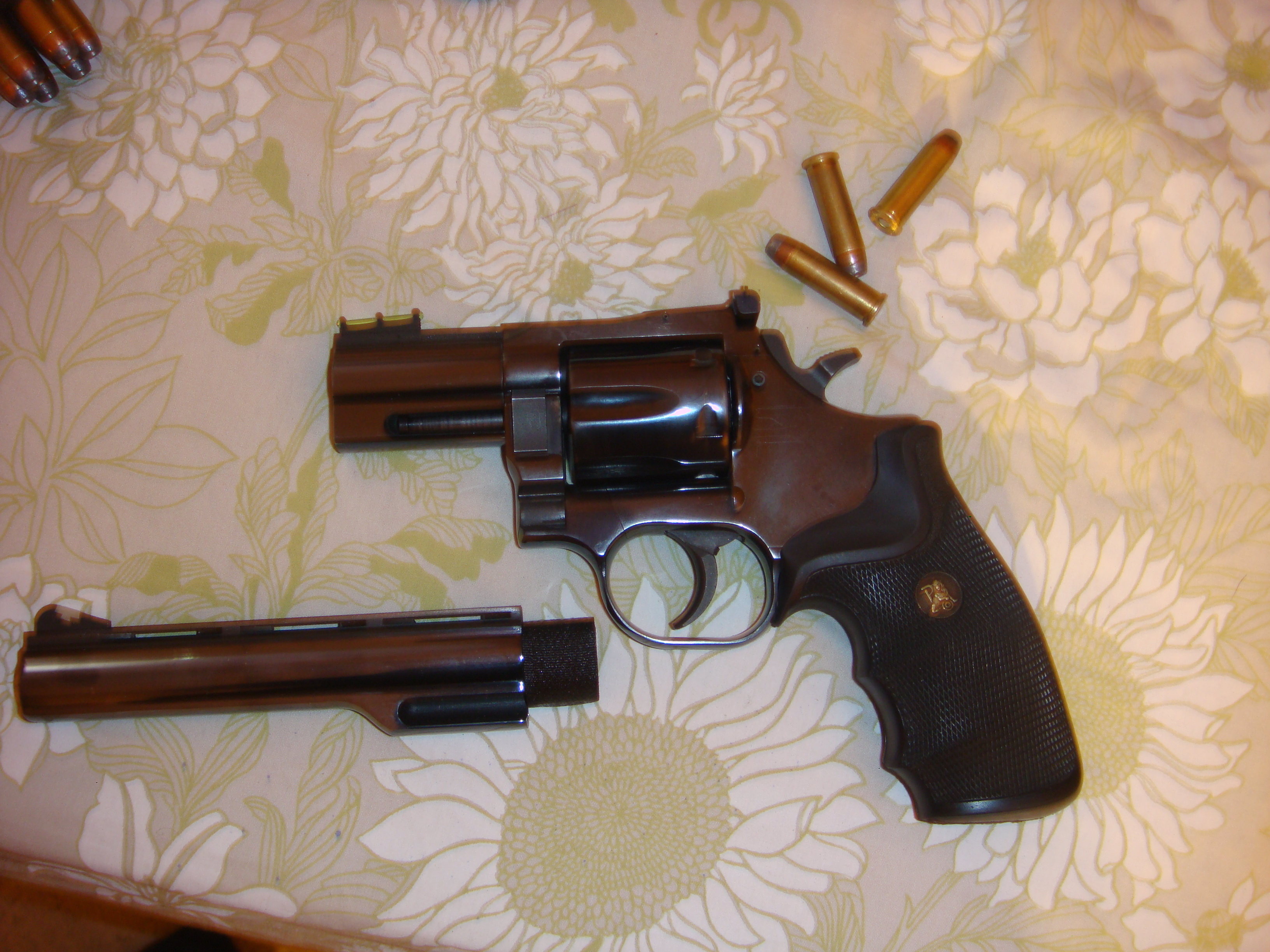

Welcome to Kydex holster making.  It is good to see other members in the forum using Kydex as a medium for holster making.  Nice definition on the hybrid holster you have pictured.  Attached is a picture of my 15-2 2.5 HV pancake style OWB holster and since you mentioned a shoulder holster, a picture of the one I have been working on.

Thanks, I have made a few holsters for DWF members.  I forgot to mention that the 15-2 4"HV in the shoulder holster is equipped with a custom LB grip and EWK barrel and shroud.  The shoulder holster works nice under a winter coat and the OWB works well under a sweat shirt or coat.

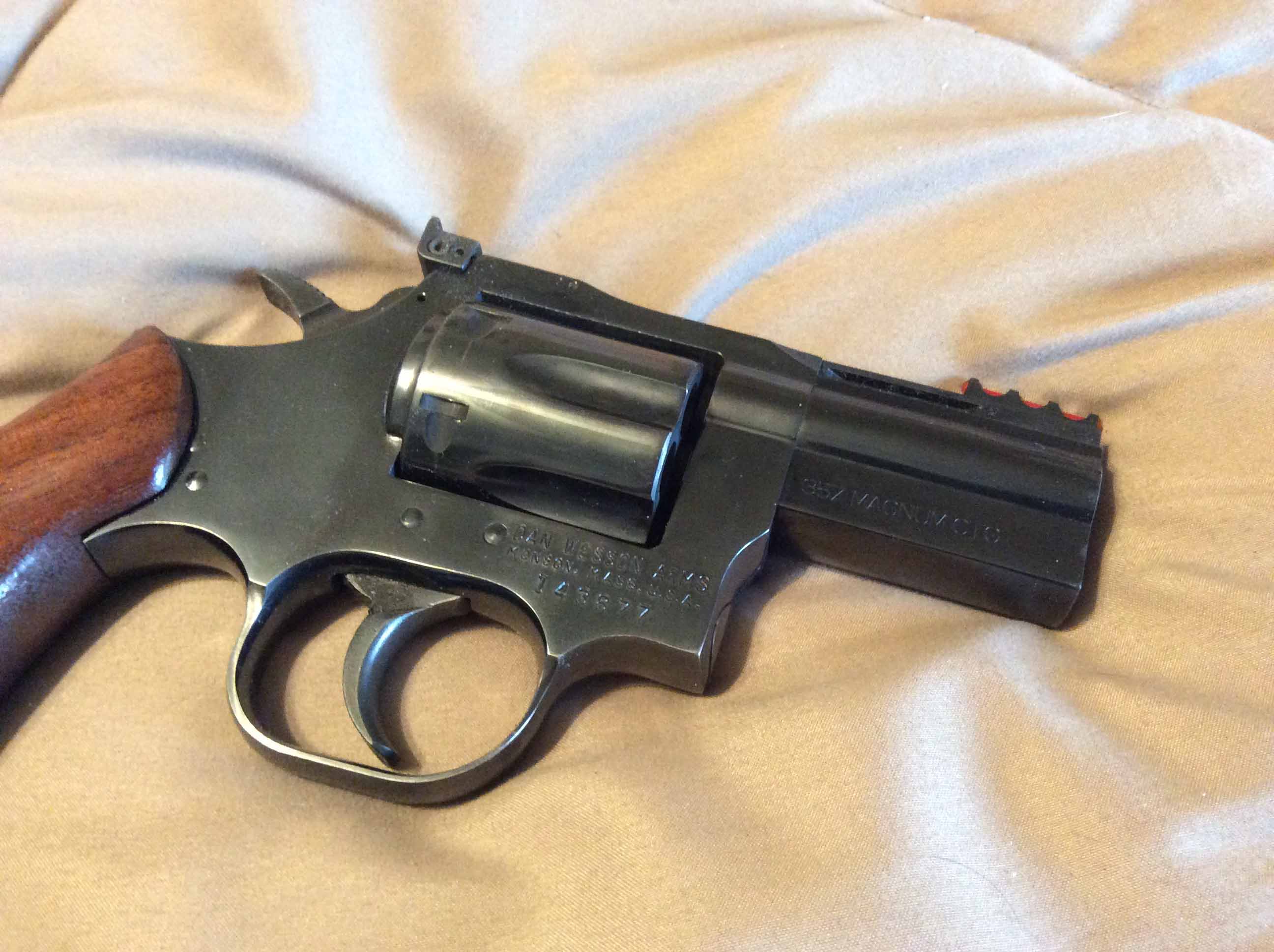

Guys ...nice job on the holsters. I recently started dabbling with some kydex for my DW 357. My question is... since kydex is so tough...how much abrasion will there be on the blueing on the gun from drawing and holstering where it contacts the kydex? Any thought would be appreciated.

Given that any holstered firearm will show wear from contact with the holster my experience has been that my leather holster showed more finish wear faster on my original DW than the DW with the 2.5" EWK barrel shown in my previous post that I acquired during the summer of 2014.  The interior surface of a Kydex holster is smooth and is less likely to keep dust and dirt inside the holster which will act as an abrasive if they are left in the holster.  An open muzzle allows you to simply wash out the holster if it gets dirty.  Since my holster uses the trigger guard as the point of retention it is the place where I expect to see wear first.  The way I look at it, is that the Kydex is a soft plastic material compared to steel of the revolver.  The plastic material should be damaged the most by the steel of the firearm.  The attached photo's show my DW as it is today having been holstered since the summer of 2014.  I wear it during colder months and at all of the gun shows that I attend while showing holsters to customers, it has seen a decent amount of cycles of in and out of  the holster with less wear than what I would have expected from my leather holsters.  If you have a safe queen and you are concerned with damage or wear to the finish, I would not recommend that you holster it and try to carry it around.
