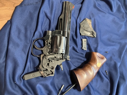

Dan-Wesson.jpgImage Enlarger
Thank you for the response! That is what I thought.
I see them thrown around in parts descriptions on E-bay and Gun Broker.
I picked up a 15-2 V4(?) with a side plate that was cracked for $300. The guy had told me that someone had tried to weld the plate. I saw heat marks, but it came off in two pieces. I ordered one from Numrich Arms for a 15 and just canceled the order before they shipped.
I see the part for the crane lock that you mentioned. I saw it in a previous post the difference.

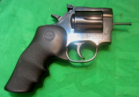

I have a 15-2 frame for $350 that's in great condition if you're interested!IMG_8035.JPGImage Enlarger

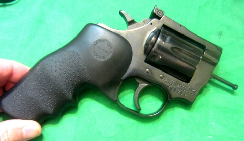

IMG_8034.JPGImage Enlarger

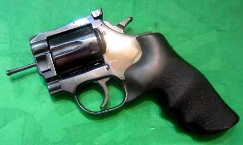

IMG_8033.JPGImage Enlarger
