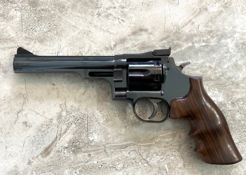

The model 15 has been on my wishlist for a long time. Then I realized that I already have what I need to create one. So this is actually a W12 wearing a 15-1 barrel assembly with a W12 front sight installed. Voila! Really looking forward to taking it to the range and sighting it in!!IMG_1452.jpegImage Enlarger

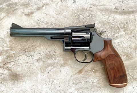

Latest grip on my homemade model 15. I’ve never been a real fan of finger groove grips, and this one feels great!IMG_1580.jpegImage Enlarger
June 20, 2024 - 5:14 pm
Gorgeous and functional, I love it when a plan comes together!
