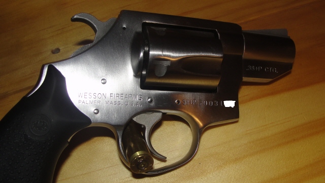

Purchased my 38+P almost 20 years ago new and have not fired it until recently.  ran about 50 rounds through it and it fired nice and accurate.  i want to strip it down and clean it up since it has been sitting in a safe for such a long time.  lost the owners manual; I did take the side cover off and the trigger mechanism seems pretty straight forward. although, how is the mainspring adjusted or removed?.....thanks  check out the pics........my local gun dealer told me that there were not a lot of these little guys made...sorry about the multiple pics....don't know why that happened...tried to delete, but would not let me.

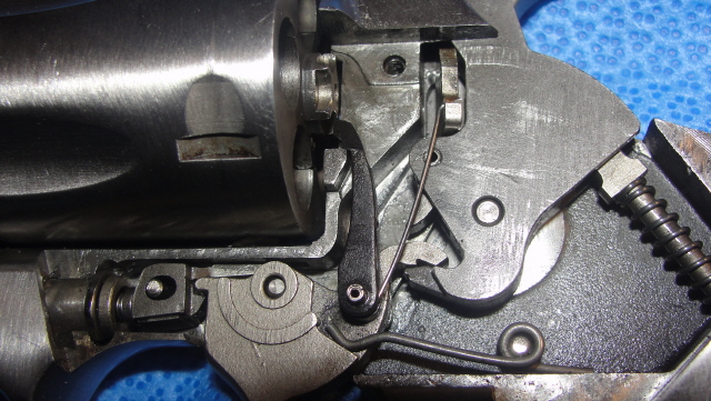

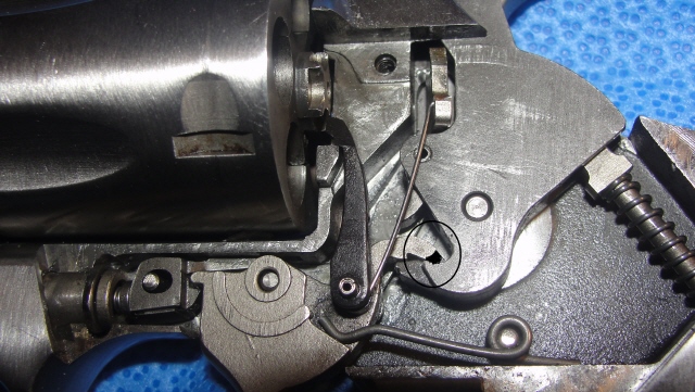

The mainspring is removed by cocking the hammer & using a paper clip (or equivalent) to hold the tension on the spring while the hammer is removed. On mine, the hole in the rod is drilled just short of the perfect spot, so a little finger pressure is still required to get the hammer free.

thanks! nice pictures!  i appreciate the pics.  is there any way to adjust the mainspring to make the hammer fall with greater force?

I don't see any adjustment on the main spring. DW may be able to make you a firmer spring once they are back up & running.
Judging from your question, are you having some FTF issues? You may try cleaning the firing pin area & then give it a light lube with Rem oil, or ATF (transmission fluid).

Yea,
having light primer strikes in DA only. I think it is a timing issue. the firing pin does not hit the primers in the center.  cylinder seems fine no play.  it is lining up correctly, but it seems as though the hammer falls too quickly in DA.  don't know what  the cause is.  maybe worn parts etc.  I cleaned everything up and still getting light primer strikes.  parts are impossible to find for this gun.  I took gun apart again and  while reassembling it the hand spring went flying.  still can't find it.....oh well, i quess it's nothing but a museum piece now.  I'll try to find it or fabricate a new spring.  very frustrating!!!!....wish i could source parts for this.....I really love this revolver, but is starting to become more of a problem then it's worth.....rick

after much thought I noticed that the trigger look as though it was either worn or too much was taken off of it.  as I said before it seemed as though the hammer was falling just before the cylinder would lock up.  i did purchase this gun new back in 1992 so I don't know if too much was taken off in the manufacturing process or it just wore out.  so I finally welded some extra material to the trigger in oreder to prolong the hammer fall.  it seems to have done the trick.  she is dhooting perfectly in SA and DA without any FTF.
