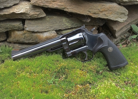

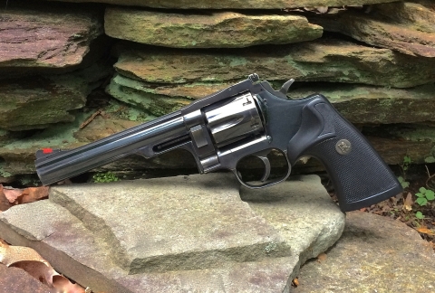

These two Dan Wesson revolvers were probably made less than a year apart, yet are consecutive models. A model 15-1 (last pork chop) and a very early model 15-2. I've tried to have a similar perspective on the photos for an easy side by side comparison.IMG_1333-2.jpgImage Enlarger
IMG_0876-2.jpgImage Enlarger

3ric that is a nice pair of should I say unpair of Dans. lol

The 15-1 is my favorite revolver, ever. It just speaks to me. It still maintains the pork chop shroud, yet has the "improvements" of the 15-2 lock work. As soon as the 15-2 was introduced, minor changes started to occur. The first was a different profile to the hammer (more rounded profile), then the cylinder bushing/crane was changed around 1978 to what we still have today. Not visible in the photos is the 5 3/4 inch barrel on the 15-1. This occurred when the change was made from an external to an internal barrel nut. The 15-2's also spent a little more time on the buffing wheel. The subtle difference can be seen on the detail on the bolt cuts and cylinder flutes. Don't get me wrong; I appreciate the refinements of the 15-2, but for me, the 15-1 is the cat's meow!

Hard to tell them apart at first glance. Nice duo, 3ric!

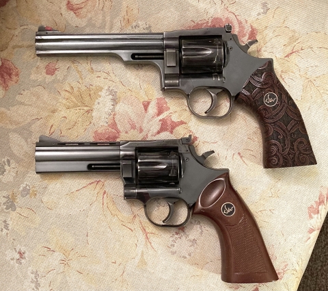

IMG_E1029-1.jpgImage Enlarger
No particular reason to post this photo except it could be considered a follow-up from two years ago. Same two guns as in post 1 except they are wearing different "shoes", and the 15-2 is also wearing an early Norwich era 4VH barrel. So, somewhere out there is the last 15-1 with serial number 49,999 and the first 15-2 with serial number 50,000 (perhaps not exactly those numbers, but close). It would be interesting to see those two guns (totally original) side by side.

Those are gorgeous grips on that 15-1.  Who made them?

I wish I had that information for you, Zedbra, but there was nothing on the eBay listing as to who made them or where they came from. I had been searching on eBay sporadically for DW grips and these popped up along with another one with a slightly different pattern. Never saw them again, but it could be worthwhile to check eBay occasionally.

SK Custom Grips in Verona, Pennsylvania is a possibility. Looks like his work, but I have no way to confirm. You could google them and inquire, otherwise I have no clue.
