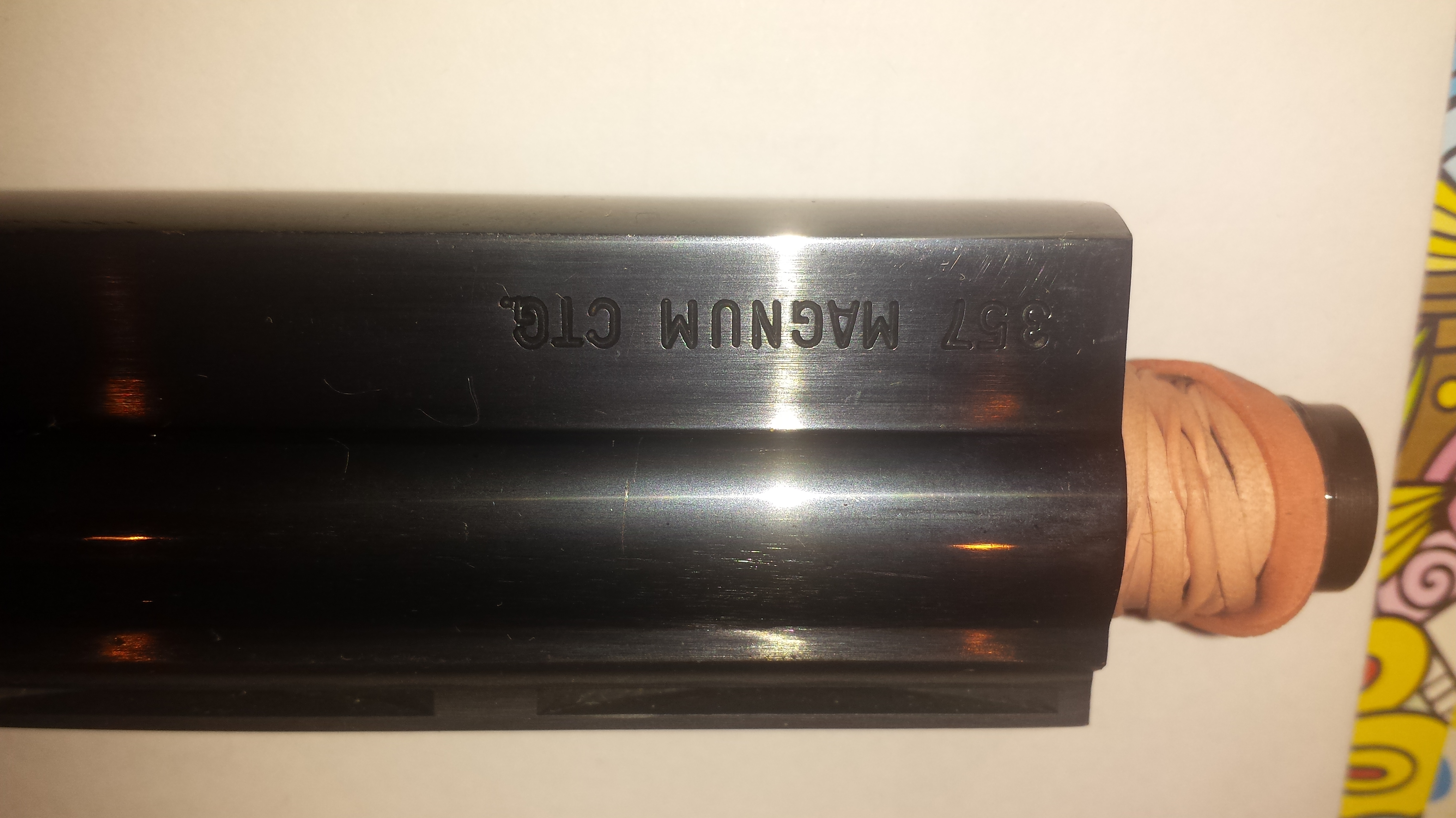

Is this a wesson firearms palmer barrel?
Klamtucky
Oregon
Forum Posts: 73
October 28, 2014
March 17, 2016 - 11:36 pm
Is this a Later wesson firearms palmer barrel. 20160317_202917.jpgImage Enlarger
Sorry for the upside down photo.
Bullwolf
Forum Posts: 138
February 29, 2012
March 18, 2016 - 1:22 am
Klamtucky said
Is this a Later wesson firearms palmer barrel. Sorry for the upside down photo.
The barrel shroud is from the Palmer plant.

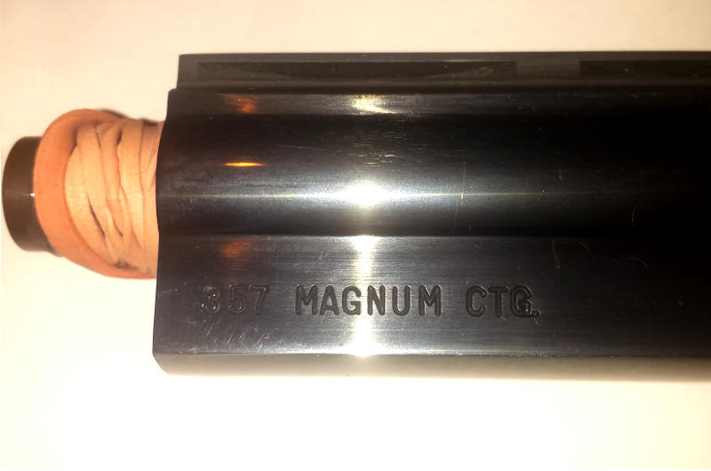

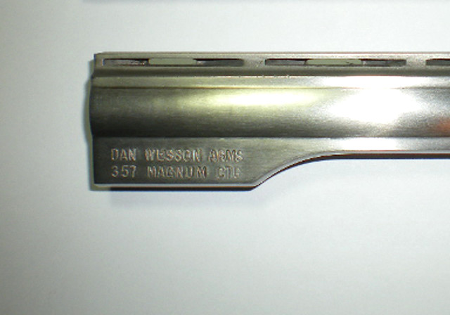

Monson Massachusetts era barrel shrouds have 2 line roll marks:
(Make) DAN WESSON ARMS
(Caliber) 357 MAGNUM CTG
Monson.JPGImage Enlarger
Palmer Massachusetts era barrel shrouds only have a 1 line caliber only roll mark.
(Caliber) 357 MAGNUM CTG.
Palmer.jpgImage Enlarger
EWK are like Palmer, one line,  but the type is larger.
EWK Arms also uses a one line roll mark. The font used is larger and thinner than a Palmer shroud.
Here's an EWK Arms EH "Extra Heavy" slab side barrel shroud example below.
(Caliber) 357 Magnum CTG
EWK_EH_BA_4.JPGImage Enlarger
Norwich NY era barrel shrouds have one line in fancy writing, that's laser etched on the shroud.
(Caliber) .357 Magnum
Norwhich.JPGImage Enlarger
[Edited to add EWK Arms barrel shrouds - Thanks Ole Dog!]
- Bullwolf
