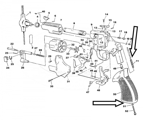

exploded-view.jpgImage Enlarger
Its a known problem.
The new grip screw is long enough to contact the bottom of the hammer spring strut blocking it.
Either, shorten the screw or put small washers inside the hole for the screw under the head to back it off enough.

If you have a screw for each grip why not just shorten the Hogue one a little at a time?
Or put one or two small washers in the bottom?

Stack as many as you need.
The ones I found were 0.040" (1.016mm) thick.If you can't find some let me know & I'll mail several to you. (I have lots of spares)

Washers are the way to go. The Hogue screws often have a different size hex head. Not a serious problem.
