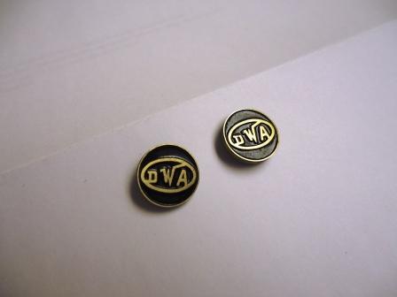

Your post prompted me to try refurbishing a set of medallions.  I did a quickie and they turned out pretty good. They actually look better in real life than on the photo. You will just have to trust me that the photo shows imperfections that can't be seen with the eye. All I did was give them a bath in solvent ( denatured alcohol because that was what I had at hand) then several coats of gloss black spray paint. Once dry I rubbed them on some 600 grit wet or dry paper and there you go.
I am confident with a little attention to detail a set could be made to look factory new.

LB, I did same thing and they turned out fine,but I had a pair that where really bad so I used spary paint remover they brushed with brass cleaning brush then did the same painting as you did then installed them on LB set of gripssmile

Waltfraz,I used charger's method of boiling in distilled vinegar and salt and I couldn't believe how clean the brass got.  I used alcohol swabs because I had no Eletro-sol. It seemed to work great so I used a flat black enamal to keep the original look and I figured it would endure. After drying 2hrs. I applied another coat (lightly) and after 24 hrs. I used the 600 sand paper to bring out the raised areas (DWA, oval and circumference ring).  Will add the pics to this topic after I get some sleep. cry
LB, yours turned out great.  I hope mine look that good.
