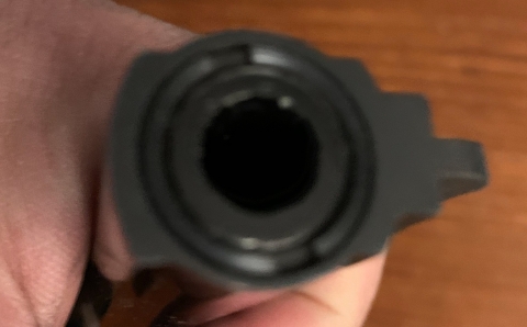

JC_68Westy
August 6, 2019
December 4, 2019 - 5:35 am
I believe that I may have found the problem. After reading the reply from grumpyoldretiredcop I checked the crown and found a decent burr at the muzzle.  =I swapped out the barrel for a known good one and will try to get out this weekend.  I also just ordered a muzzle lapping toolset from Brownells.
IMG_0239-1-1.jpegImage Enlarger
