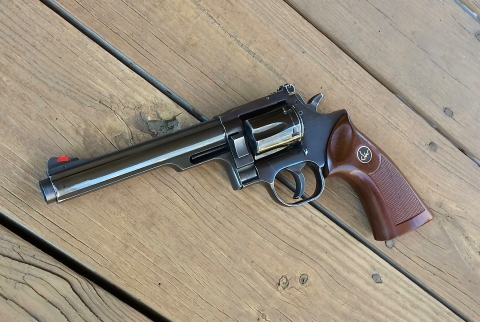

Decided to try my 6 in. 15-2 barrel on my 15-1 DW while I'm trying to analyze some problems with the original 5 3/4 in. barrel. The first barrel nut seats in the recessed shroud as intended, and the second merely protects the extra 1/4 in. of exposed threads beyond the shroud. Kind of a cool retro look.IMG_1160.jpgImage Enlarger

Yes, it occurs to me that this is indeed a FrankenDan revolver. Frame from 1974, barrel from 1975, and grip from around 1980 or so. Maybe it's just me, but I think it looks really cool. Shoots great!! No worse than mounting a 15-2 or later barrel assembly on a pork chop frame with an adaptor.

looks good , and what really matters is that you said it shoots " great " .

It looks like the barrel is not screwed all the way in.

It does kinda create that illusion I guess. I just feel that the extra barrel nut looks better than the leftover 1/4" of exposed threads sticking out. Gap is set at .004, and shows no evidence of movement after a hundred rounds or so.

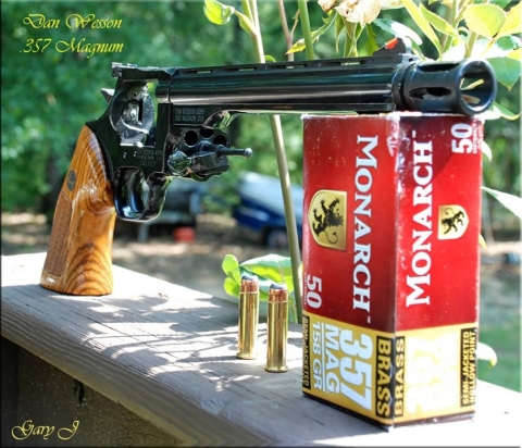

I know what. You need a A-2 Bird cage on it. I don't know if EWK still sells those. I have one on my 15" barrel. Most gun guys can't believe it. This is an 8" barrel in this pic.Nikondwfmaster9ABZ.jpgImage Enlarger

Gotta admit the A-2 Bird cage gives it an interesting look alright. Not sure it's my style, but thanks for making me aware of it.

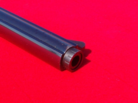

That looks like my model 15, this came to me wearing a W12 BA. At first I thought it was supposed to be that way. But research shortly after told me that the 15's came with the flush mounted nuts.
The nut is fluted on the end & is removed with the same size wrench as the W12's.

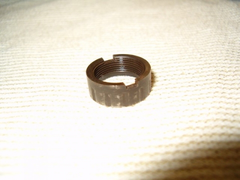

Yet when I removed it, it has notches in it like a normal 15-2 style nut! I have yet to see another nut like this one, and at this point, I'm not sure if it's a DW part or one someone made.

That's a great looking shot! Mine is pathetic in comparison. screwy

Great looking Model 15 in post 9! Very interesting barrel nut. It looks like it can be used on either a pork chop or a standard shroud.

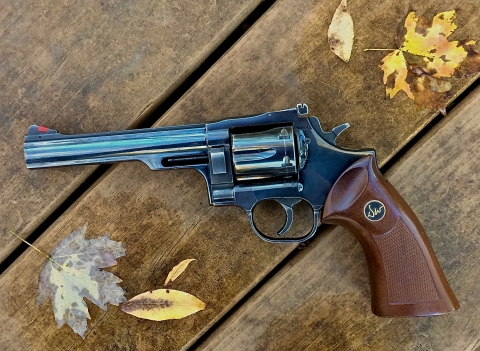

I've finally been able to make the necessary repairs to the original 5 3/4" barrel on this 15-1, and have reinstalled it. Did some de-burring to the forcing cone entrance and Flex-Honed up to the rifling. Hopefully I'll have no more leading/flaking issues. Looks much better without that extra barrel nut. This is how it looked when I bought it.IMG_1138.jpgImage Enlarger

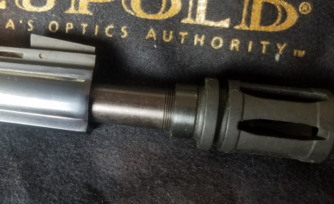

     Hey Eric I just saw this post on the bird cage. You can tighten it by hand. It fits a .357 mag. barrel and ctg.. Its threaded for a .500 th barrel dia. The inside dia. Is .400 th. It could be bored out. I would make sure you can slide a ctg. through any flash hider or muzzle brake before I shot it.  Here are a couple of pics.rn

Thanks for the photos, Gary! Very interesting look it creates on the gun, but I'm still not sure it's me.

That is a really long barrel,
The 5 3/4 looks great
