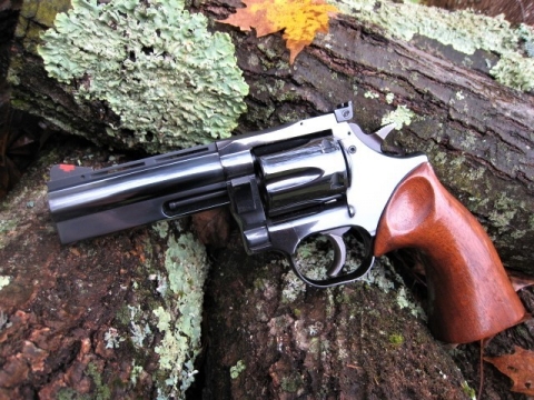

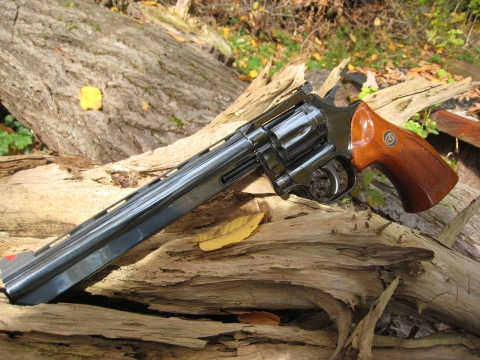

While browsing GB yesterday looking for a nice DW 15-2 frame I ran across a 15-2 w/ VH8" with a high bid of $405 with 8 hours left to bid. A couple FFLs ran the price up to $605 probably to flip it. I dozed off and woke up with two minutes left & bid $610 which was as high as I'd go on this one and won. Figured the barrel was worth nearly $400 so I got my frame rather cheaply. Seller was an FFL but wasn't very familiar with DWs apparently since it was listed as a Model 715. Seller said the action was locked up when he took it in and the trigger doesn't always reset. Cosmetically looks good from not so good dark/few photos. Figure the trigger over travel set screw needs adjustment and maybe the B/C gap is non existent and making contact like my first 15-2 or carbon build up. I've gotten very familiar with taking the DWs apart now thanks to "Average Joe" so I think I can fix what ailes it. I guess I'll find out when it gets here. Here's my other two.stonebuster-15-2-04jpg.JPGImage Enlarger

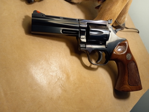

I picked up the gun today & am very pleased. Cosmetically better than expected and arrived with the trigger return issue the dealer had been honest about. I adjusted the overtravel set screw a little at a time until it reset consistently. When I tried single action the gun locked up and hammer wouldn't drop.  I realized my overtravel adjustment wasn't allowing the trigger to move far enough to release the hammer. Put a spare trigger I had in and all is perfect now. Thanks to what I've learned on this site she's fixed. Thanks!!20240509_143939.jpgImage Enlarger
