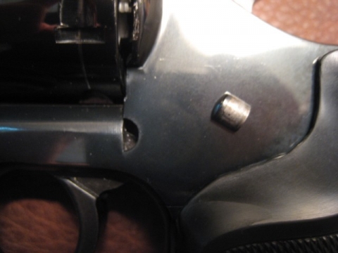

That bad news is after 30 rounds of 38spl the cylinder stop fell out of the side plate on my 15-2. The good news is I found it. I read red lock tight or crazy glue works to hold it. I realize I need to remove the side plate and make sure the stop is flush with side plate. I'd rather use lock tight than crazy glue. I'll order an extra one or two if they're avaiIMG_0221.JPGImage Enlarger
lable. Any advice from you experts is appreciated.

Congratulations on finding yours. I was not so lucky.
Be careful pressing it back in. If you don't support the sideplate it can crack. I didn't use anything special, just rubber inserts for my vice.
Red locktite is a good choice.

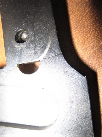

After the warnings about cracking the side plate I took a close look before I started and it appears to be cracked at the weakest point already. The crack isn't visible anywhere else but where the photo shows it. Not on the sides or polished top of the side plate. I reinstalled the cylinder stop with red lock tight and I guess I'll just keep an eye on it to see if the crack travels. A previous owner may not have heeded the advice given here. Only had the gun for a few days and had to reset gap, blue lock tight the ejector rod that was loosening, reinstall the cylinder stop and adjust the over travel screw on the trigger. Now a cracked side plate. Looks like it's project gun but I'm learning a lot and for some reason still like the gun a lot. I thinking it probably wouldn't be safe to shoot even 38 spl without running the risk of damaging the gun or worse. Correct?

I wouldn't be concerned with that- particularly if it isn't showing a crack on the edge of the bluing.  Just be mindful when installing the side plate and don't force it.  Continue to shoot normally.

Now that's what I wanted to hear. The truth is, I was probably going to keep asking until someone told me what I wanted to hear. Thanks. Is there anything I could try using to keep the crack from traveling?

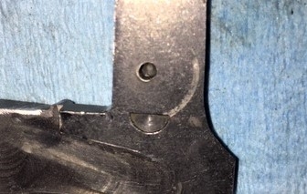

I'm not 100% convinced it's a crack. Many side plates have the same or similar lines in the same place.  It may be a result of the manufacturing process. If not, I have a 15-2 with the same issue that is regularly fed 158 gr .357; no issues.

That's interesting since your's is in exactly the same spot. It's hard to tell from your picture if it's jagged like mine. I thought it was a machining mark until I noticed it was jagged looking. Since it originated at the hole(weakest point) and was jagged looking made me believe it was a crack(maybe not). Either way I'll keep shooting and not worry about it. Happy to hear it hasn't been an issue and thanks for your post.

I think the world of the other Ron but I suspect it is a crack. Just not all the way. I haven't been on the forum much lately so I was a little late in warning you about hitting the ejector rod hard if cases are stuck. The cylinder stop did not fall out. It broke out. Dan Wesson sells replacement ones that press fit in with red loctite to hold it. The edges of yours may be ragged and hard to put back. Snake-eye may have some also. The design flaw was corrected in 1981 on stainless guns and in 1986 on blue guns.
  If your sideplate breaks it is more serious. Dan Wesson is out of stock and sideplates are fitted before the frame is polished and blued. A used sideplate is your only option and very difficult to fit right. I have a couple of used ones but they are scratched and may not fit well. As Ron said, don't force it in and you should be alright. Most sideplates break being forced in.
