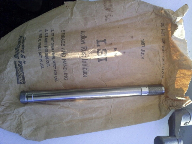

ran across this not sure if .357 max.....375....a .357 doesn't go all the way in muzzle and does go into cyl end....total length 8inDW-357-max.jpegImage Enlarger

Looks like a 357 Supermag.  It is NOT a 357, its much too heavy and has the reinforced areas.  A pic of the bore would help narrow it down a little.  If you have a 357 caliber bullet you could see how it fits in the bore.  If its a 375, a 357 would drop right through.

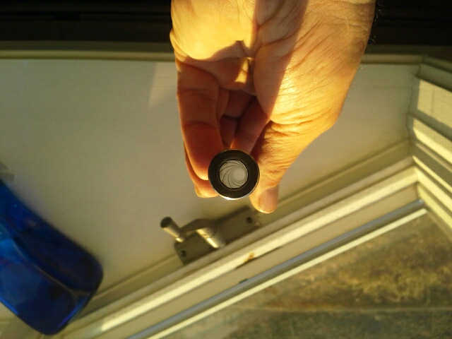

January 13, 2015 - 7:01 pm
DW-8in.jpegImage Enlarger
 I did check with a .357 loaded rd....tight at the muzzle..... and it fits in the forcing cone...with the paper dated 1981....Iam not sure when .375 came out....but I think it was after 81....I don't think it's ever had a rd thru it...

That looks just like a .357 Supermag barrel.  That is what you have if the bullet is fitting correctly as you indicated.
January 13, 2015 - 10:02 pm
I agree; .357 SuperMag. One of the distinctive features of the .357 SuperMag barrels is that the middle portion of the barrel was milled to reduce weight as you can see, yours is done that way. That was done because they used the SuperMag barrel blanks which were much heavier than the standard blanks.
Now, I don't have a .375, so maybe they were done the same way, which would spoil my theory.  I still think Mike and Phil are right.
Try threading it into a frame. The threads are different so that you can't make a mistake.
