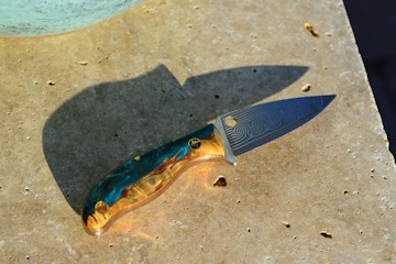

Another hobby of mine is making custom knife handles.
This is one that i ade for my wife, The blade is a Spyderco Mule Team Demascus in VG-10
The handle is Tiffany Burberry Shokwood with brass and copper liners.
Just a way of making things that I could not afford otherwise.
Unfortunately, the picture does not do it justice as the Resin portion is so smooth it looks like glass in person.
