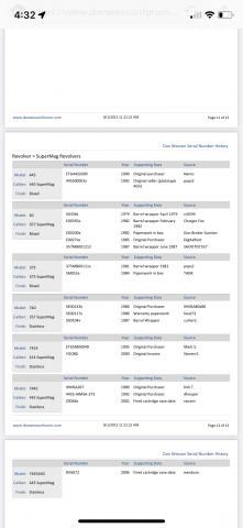

Has 375 SuperMag revolver ever been made in stainless steel? I saw a picture of one today, but there was something strange, I think….never heard about one and all those I’ve seen have been blued. The strange thing was that gun had Palmer address and the caliber marking was different from the address text, like someone had taken away metal and then made a new caliber marking deeper than the original (which I assume has been 357 max). The gun is bright brushed stainless, but all Palmer- made stainless SuperMags I have seen earlier are matte-brushed. So, can the gun be original, or am I over-suspicious when thinking that the gun is a conversion made by some gunsmith?
April 13, 2022 - 5:34 pm
0F803089-F269-4197-A24F-A52482622F46.pngImage Enlarger
From what I can tell looking at the DW Serial Registry, they were only produced in blued.
