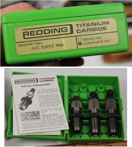

Man-o-man, an ETG 445 for $375 is redonkulously cheap, at least these days.  The Gates brass is desirable too.rnReloading is fun and not difficult at all.  I’m not sure I understand 10Magnums comment about reloading revolver rounds easier than semi autos because revolvers require a more stout roll crimp whereas semis are taper crimp or no crimp at all.  Anywho, a few YouTube videos and a good book will get you on your way to reloading.  rnReloading gets progressively less expensive after you reuse the brass once, think of brass as a one-time capital expenditure vs operating expense/consumables such as primers and bullets.  Getting powder (and bullets) may be a little challenging but Midwayusa had 8lbs jugs of Hogdon H110 available right now, and not for long after this posting.  You can make an army with 8 lbs, and the powder will store a decade or more.  445 Bullets will be standard 44 magnum, albeit heavier grain choice for the 445.  Dies will be standard 44 mag too and I always recommend going with carbide.  This means you’ll be able to reload 445, 44 mags and specials with all the same equipment.rnHandgun boolits are easy to reload compared to rifle rounds, and the 445 is as easypeasy as any other handgun load.  Buying reloads is risky because you never know what you’re getting, and some idiot might have over pressured rounds that aren’t safe or will stick in your cylinder as the brass over expands.  Good luck and hit up the forum for any suggestions.

I have the Redding set also.
When I said revolver reloading is easier I should have expanded on my reason.
Bullet shape does not really matter as long as you watch the OAL when loading for a revolver.  Pistol reloading requires watching the OAL and watching head space. A tapered round nose load can have a much longer OAL than a flat nose bullet load. If you drop a loaded round in a barrel and it hits the rifling before it is completely in the chamber the action will not close on a semi auto. Bullet shape for autos makes a big difference.
