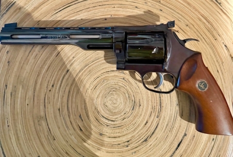

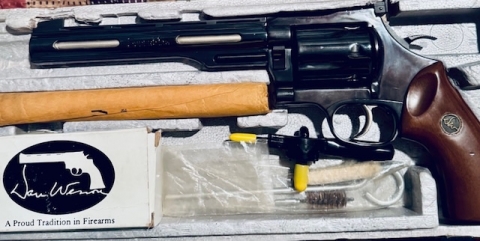

Newly acquired

Was going to go out and shoot it tomorrow.  Then ammo popped into my head.  Do I need to only shoot 357 Remington Max 158gr?  or?  Thank you

It will shoot 357magnum and 38 special also!
Thank you.  I appreciate the info.

It won't be nearly as accurate and you'll need to monitor the fouling in the chambers.  Once you have a carbon ring, it will be difficult to chamber and extract 357 max until it's removed.

There are some things you should know about your treasure.   There is an extra barrel for a reason.    The 158 grain rounds have been said to contribute to flamecutting of the top strap and barrel cone erosion.   Don't panic.   This occurs after thousands of rounds.    One solution was the extra barrel.   The other was the recommendation of 180 grain cartridges.   Keep the gap at 0.002.
I myself still shoot 158gr that I have.   But I reload spent cartidges @ 180gr.
