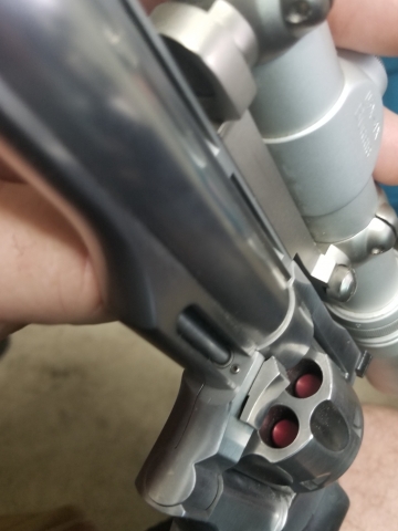

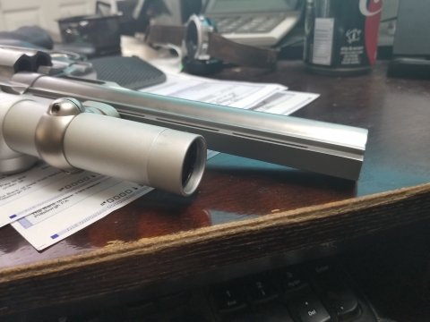

Before I get into the pictures I do have a question about something I have not seen before on the Dans.
The front shroud has no front dovetail, I thought maybe part of a hunter pack but the pictures of the hunters I have
seen all have a front sight. I have to admit it makes for a sleek line to the gun, albeit very large sleek line.
Here are some pictures.
I have included a shot of the minus dovetail.

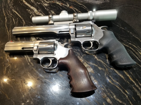

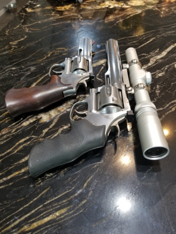

A comparison to the little dan 715,
20180730_165552.jpgImage Enlarger
20180730_165614.jpgImage Enlarger

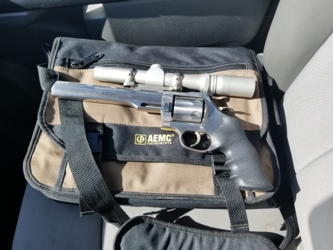

And the comparison to my briefcase. It may not be a 7445 but man this thing is big!

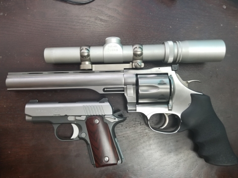

And a comical comparison to my daily carry Kimber micro 9 CDP.

A separated IFP barrel assembly, unless your SN# begins with IFP...

Thanks RWSEM
That gives me th information that I need.
Unfortunately the serial # starts 44 S00 so it is not a complete IFP pistol but at least I know
about the configuration that I bough it in.
A shame it would have been nice to have found a rare one.

Nice 744 there. I would carry the DW and leave the Micro at home.big-grin

Not a bad idea but I think I will wait until Eric gets the 4" barrel/shroud ready for me.
Or I could carry my model 715 in 4" configuration, problem is my antigun office would probably frown on this.
Hmmmm how to conceal carry a 744 with an 8" barrel let me think about this one for a while........

Palmer made a Deer hunter model that was scoped with no front sight. The one I saw for sale was blue. A forum member won it. Maybe Scorpio?
The question is were they all stamped as a Palmer. Mine is stamped Monson although
I seam to recall seeing it stated that early Palmers still had the Monson stamp and my serial number
places it close to that time frame.

You have done your research well!! If it is a Monson leftover it would probably have a one line roll mark on the shroud. Circa 1991. There may be a difference in the degree of polishing on the shroud compared to the frame also. If these were S&Ws collectors would pay a premium for them and call them " transition models".

So given the telltales that you given I would say it is a true Monson then.
Polish on shroud matches the frame and has 2 lines of ROLL.
DAN WESSON ARMS
44 MAGNUM CTG.

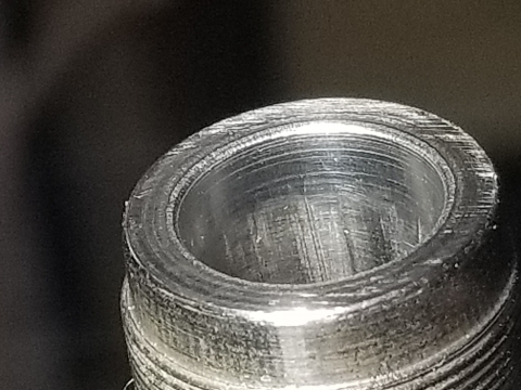

So an update.
Yesterday a received a barrel nut wrench from Eric. (such a great resource and vendor)

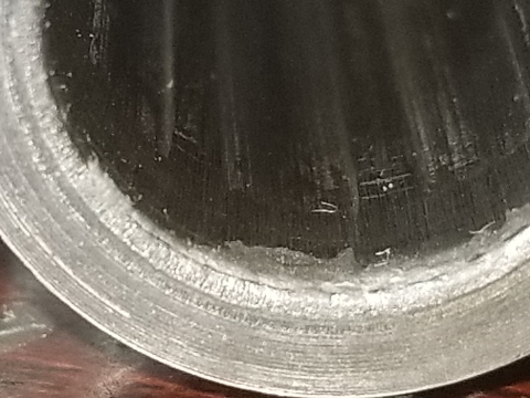

I tore the barrel off last night and looked things over out of the frame.                                                                                                                                                            This is something I have been waiting to do so I could do some detailed cleaning that could not be done very well with it all together.
So with the barrel out, I could see the forcing cone better and the area looked for all the world like it had erosion or leading. This was the side against the topstrap so it may be that I was unable to get a good angle to clean like the rest of the barrel.
20180818_112057.jpgImage Enlarger
But since I have the barrel out I can try some things and low and behold it is just carbon build up or maybe leading on the front edge.  See the pictures below. I used a large countersink by hand along the edge with no pressure and the bonding went away. This allowed me to see that while there is a little bit of erosion the forcing cone was not part of it just the leading edge of the barrel.
Here is a picture after cleaning it up.
20180818_172432.jpgImage Enlarger

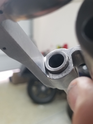

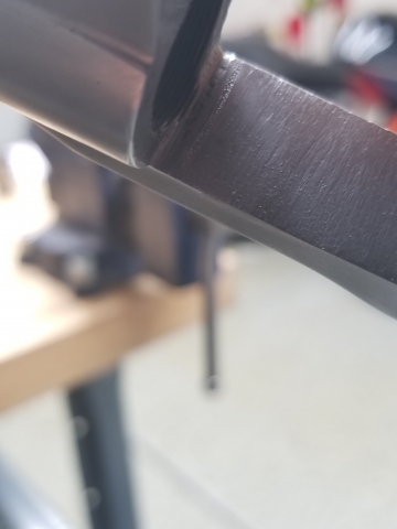

So while the barrel was out I did some of the other cleaning I wanted to get done. This included cleaning the topstrap and the inside front edge of the frame of any traces of carbon. The machining looks a little rough on the leading edge of the frame inside but I am sure it will work just fine.
20180818_175024.jpgImage Enlarger
As can be seen in the pictures there is a little flame cutting on the topstrap but considering this is a 44 magnum I am pleased how little it is. My 715 shows more than this.
20180818_174844.jpgImage Enlarger

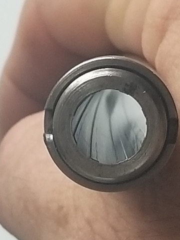

I also took this time to polish the bore of the barrel. I had previously cleaned it with JB non embedding compound. Today I took it further with using JB Bore Bright and doing 100 laps of the barrel with the crown butted against my bench to prevent altering the crown area of the barrel. As I previously mentioned the rifling looks very good with sharp edges and no pitting. Hopefully the lapping will make cleaning a simple chore in the future. (Not having owned a 44 Mag before this is something I will be learning moving forward.)
20180818_172955.jpgImage Enlarger

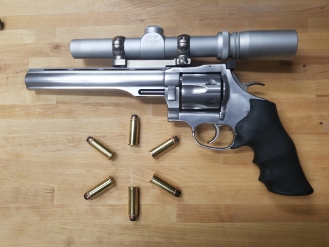

So now that he is clean,
"Big Dan" is ready to play.
I have included a few last shots one of the clean gun before it gets dirty again.
20180818_181442-1.jpgImage Enlarger
Here is a shot of the front of the cylinder after the cleaning I did last week.
20180818_224601.jpgImage Enlarger

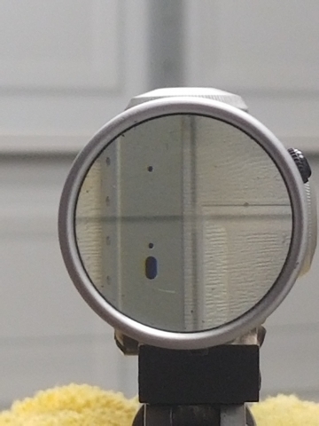

The crosshairs are only out of focus because I could not get the camera to focus on that point they do look clean and sharp in person.
20180818_181858.jpgImage Enlarger
It has truly been a labor of love getting to this point. It was much dirtier than the ad would have you believe "This gun doesn't appear to have been fired much at all." The usual marketing BS.
Soon we shall see if he shoots as well as he looks, he is a handsome devil. Ha, ha!
