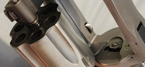

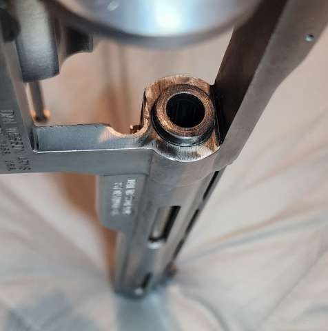

I am gonna assume this isn't too bad when it comes to flame cutting the top strap?  Also how's the forcing cone look on the barrel?  I still need to check and see just what twist rate barrel it has since Dan Wesson made 3 different ones?

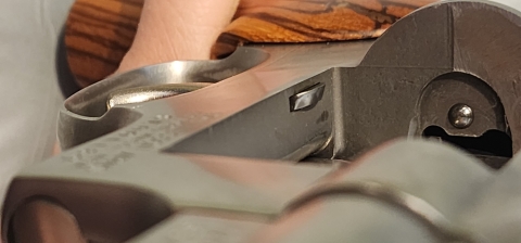

Also is the Bolt for the cylinder supposed to be shaped like that or should it be more flat across the top vs the significant angle it has now?

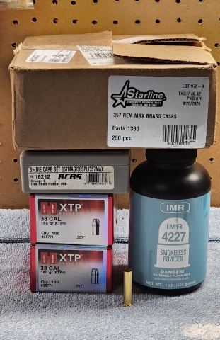

I managed to scrape together everything I didn't have for reloading the little beasty.  To be honest if starline didn't offer brass for the 357 max I probably would have passed on it.

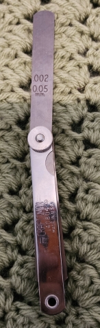

Scotchbrite that the forcing cone-end of the barrel and cylinder to remove any buildup, then set the gap.   The barrel gap is 0.002" on the proudest chamber.

Nice grab- that flame cutting is nothing to worry about; it looks like it's reached the point where it will no longer continue to erode.  The bolt is the correct shape as well.

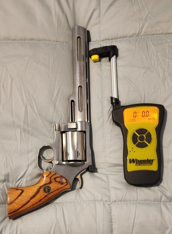

Had a free moment tonight to check the trigger with my gauge.  In SA I averaged 2lb 10.5oz on six pulls which is almost identical to my 744 and 715.  Next I tried pulling in DA but it maxed my gauge out at 12lbs only half way through the pull.  My 744 also maxes the gauge out but it more at the wall not half way.  The 715 actually breaks in DA at 9lb 6.3oz.

I also got the chance to check the current cylinder gap.  The .002 went in cleanly and the .003 would just start on a few but would not pass cleanly

You're all set!  Go reload and shoot and reload again...
