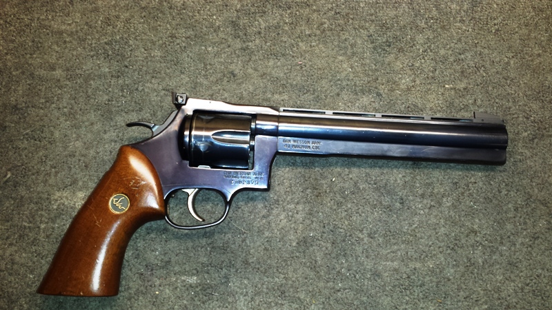

Here are a couple of pics of my newly acquired 41 Mag.
Made in Monson, Mass. Serial Number is COO2473
20150314_111443.jpgImage Enlarger
20150314_111429.jpgImage Enlarger
March 22, 2015 - 11:59 am
That's a sweet looking 41. You are going to enjoy shooting it. My 741 is a ton of fun.

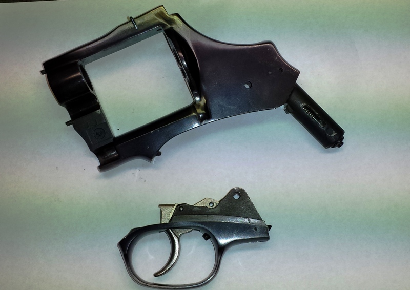

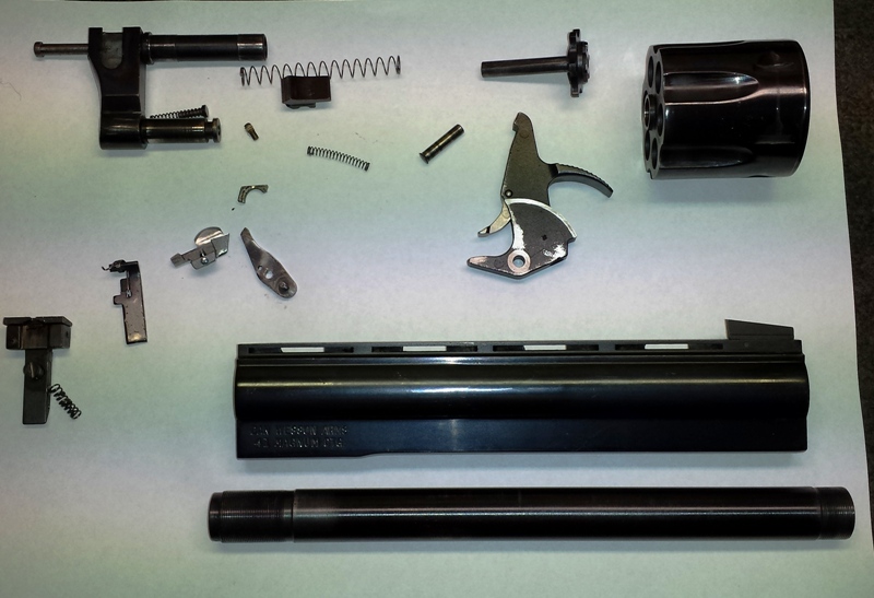

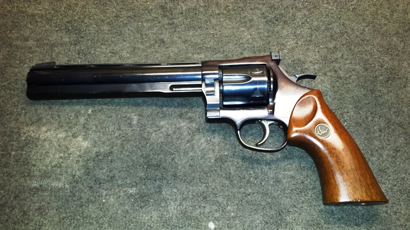

Thanks for those links Mate, I have it stripped right down and cleaned her up, Here is a picture of what she looks like now. One thing I couldn't work out was how to take the ejector rod out.
April 7, 2015 - 1:19 pm
Well, Ken I actually thought the rod should pull out after the star is unscrewed. I see the spring came out. Maybe it is just caught up in the bushing. If it doesn't want to, I wouldn't force it. They bend way easier than you might think... You are on the right path tho, my friend..

It has another larger bit inside that is either screwed onto the ejector rod or is a very tight fit. But I might leave it alone in case I damage it. I will put it all back together later today. except for the barrel and shroud.
April 7, 2015 - 1:30 pm
I can see where you mentioned the B. N. threads. Looks like they cleaned up well. Someone over torqued the nut is my guess. likely more than once and may have never lubed it. Though, it doesn't take much. I have been using a dry lube on my sporters and it seems to work very well. I may have to try it out on my 15-2 next time.
April 7, 2015 - 1:37 pm
You guys who run the large Dans correct me here where necessary, Since I do not own one yet...
You might, Ken, put some light on the rod side of the cyl. guide, then work the rod while looking into the spring hole to see if the bushing moves with the rod.   Try pulling outward while trying to turn the rod in un-thread direction. Not a lot of real force, tho.

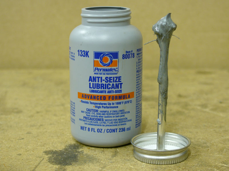

I use just a dab of silver Permatex anti-seize (applied with a Q-tip) on both the barrel threads, and the barrel nut. It's the same stuff you would use on exhaust manifold bolts, and tire lug nuts. Just a bit of added insurance, so I'll definitely be able to remove the barrel nut later.
I've dealt with a stuck barrel nut before, and it's not fun.
Now I do the Anti-Seize thing on both the 714 and the 7445 Supermag. Can't complain with the results, as I have not had a sticky barrel nut since.

I couldn't get the ejector rod out ,The bushing turned with the rod. I have put the Revolver back together except for the barrel and shroud, Cecil is sending me a couple of barrel nuts ( Thanks Mate ) and once they arrive I'll lube the threads and nut, put it together and take it out for a shot.
